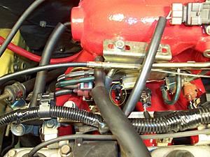

From: va
Unhappy IM install, help
so yea, i just installed a new IM and the CEL came on so I looked around for what it could be and noticed that there was a tube missing. I took some things apart again and tryed looking for it but could not find it. you can see in the pic attached what i meen. so i was wondering if someone could post up some closeup pics of theres.
thanks,

I actually already went to autozone, the code # was P0455 which is an EVAP leak.
It says probable causes are
1. loose or missing fuel cap, which is not the problem
2. evap canister broke, hose cracked or not connected
3. Purge or vent solenoid defective
4. Vacuum leak at engine
Im pretty sure the problem is the vac line missing in the pic.

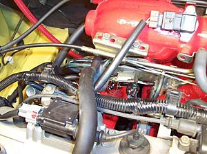

here some more pics
Attached Thumbnails help, IM missing a tube?-004.jpg   help, IM missing a tube?-007.jpg   help, IM missing a tube?-013.jpg   help, IM missing a tube?-016.jpg   help, IM missing a tube?-017.jpg

I put a circle around all the pics were one end of the vac line should go, I just can't find were the other end would go.

i THINK that is the evap purge solenoid... i may be wrong though. the line should be connected somewhere on the IM if i remember correctly. i think it was somewhere underneath the fuel rail where it was connected. i'd go check my car if it wasn't midnight and pouring rain outside. i will see if i can get a good look at it tomorrow.

this is what i saw, that should be connected to a long tube that goes under the car, looks to me like fuel line because before it goes under the car it connects to a metal tube

you dont really have to jack it up ,it connects under the intake piping to a metal line

well i found the the metal line and hooked it up, started the car and no more CEL. anyway thanks a lot man, really appreciate it!
