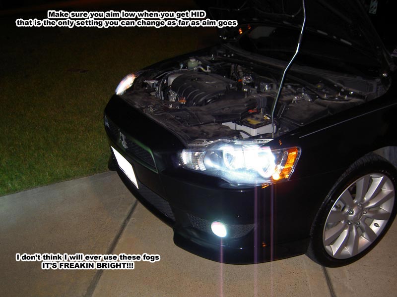

more pics

you can operate it the same way, only difference is, when you turn the headlight switch once to usually just turn on your parking lights, it will also turn on your headlights. The fogs also has a harness just plugs into the OEM plug, to turn on the system.
this seems to be only inconvenient for people who like to wait for people at night and just want the parking lights on.
If you really want to have parking lights, you can always install undercar kits, just make sure you remember to turn it off when you start to drive.
