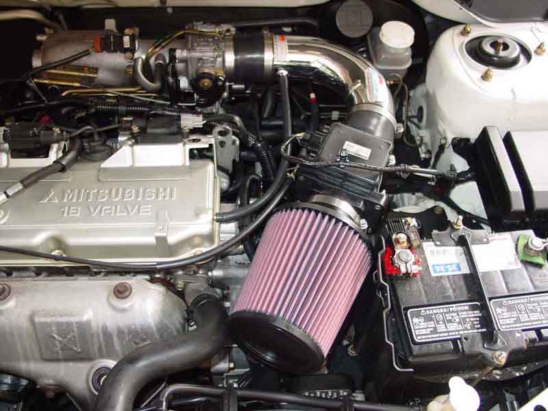

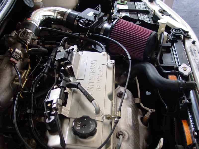

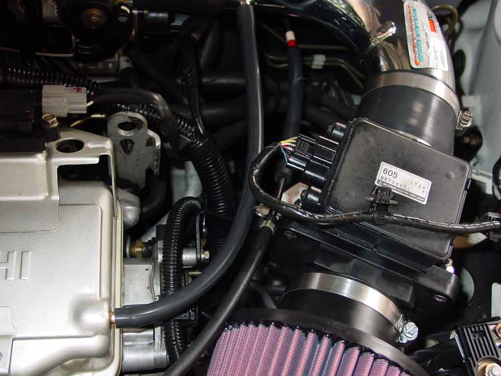

photos uploaded.

Hm...can't exactly tell if anything is wrong in the picture. Seems like you hooked it up right. Can you confirm that the intake is on really tight on the throttle body? Make sure your intake filter does not hit that terminal or sparks will fly and it could damage your electrical system and possibly kill your battery.

its secured tightly in the throttle body. the filter is kinda hitting that terminal by bit so i bent the filter. probably i'll bend it i lil bit more.oh and about the weird steel like denting sound, probably because the car have many miles on it(123k).
