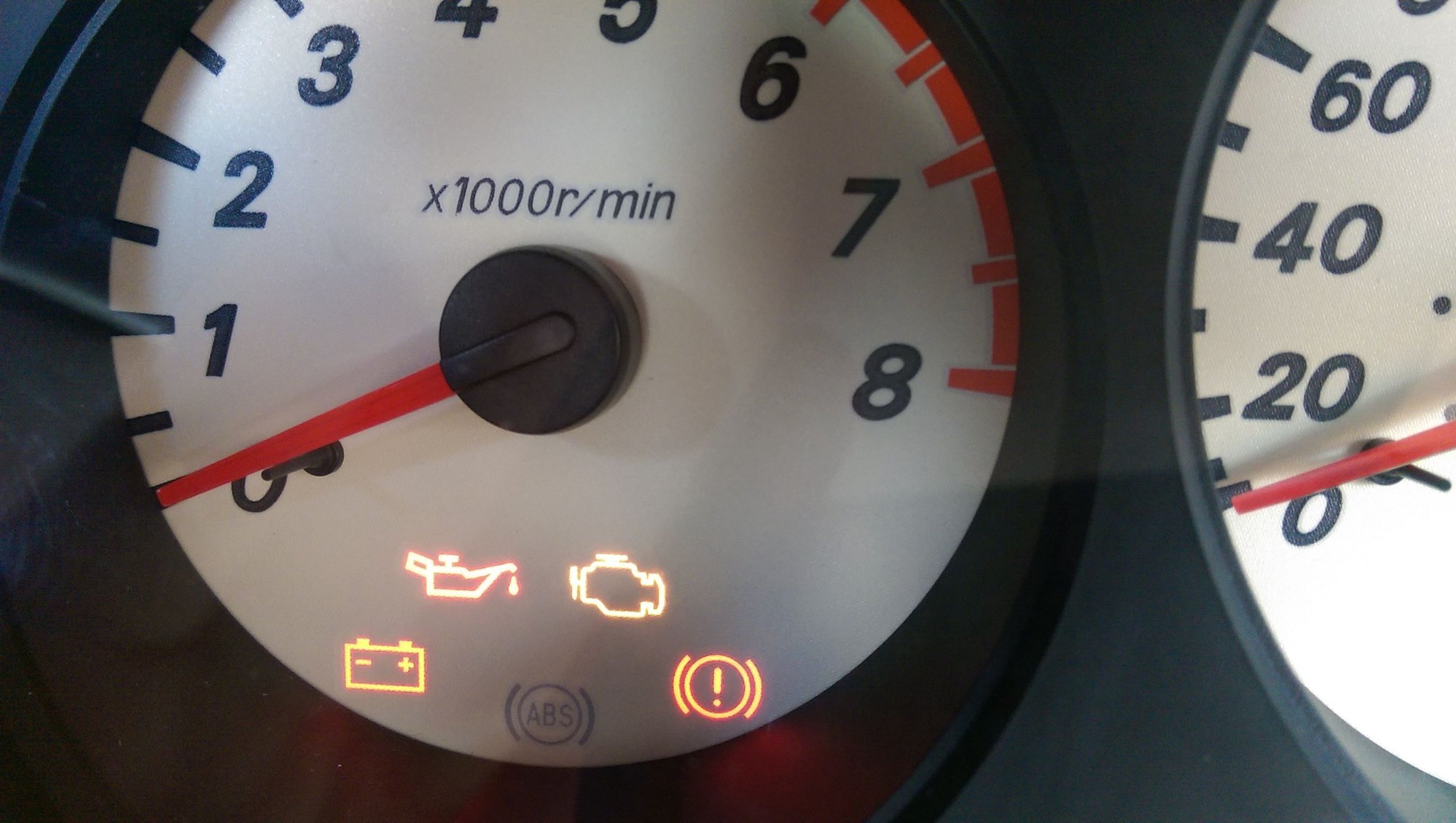

Hey every and thanks for the help in advance! I'm having that hardest time figuring out whats going on with my car.
Anyways here is the story. The instrument panel completely stopped working (gauges wouldn't move, however the lighting worked in the car. I went to my local wreckers to grab a new instrument panel. I then proceeded to install it.
Now what happening is all the lights are not working. I cannot drive in the dark knowing my speed. However my cruise control, srs, airbag, seat belt lights are on and work.
My gear selected is not lighting up and my lighter works, but not the bulb that lights the ring.
These are the things I have done to try and see what was going on.
- Searched through the forums to see if any one else had same issue. Attempts to use their fixes did not work.
- Checked the connectors on the instrument panel
- Replaced every single fuse in the car. EVERY single fuse.
- Checked wiring harness
- Made sure dimmer switch is on high
- Left the battery out for an hour
- Replaced the dimmer switch with a new one
- placed old instrument panel back in and now has no lights.
- OBD2 scan with no codes or pending codes
If anyone has any more suggestions please let me know

So I tried what you posted and no change. Still the "check lights" show, however the dash will not show anything.
