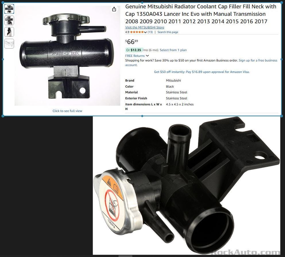

Water Outlet - Find part
My water outlet on my 09 Lancer DE started to leak. I looked on Rock Auto and also checked with 2 local auto supplies. All 3 sources there was an extra fitting on there. Finally I found the right on on Amazon. It's actually OEM too! I'm including a picture of comparison and it has the part number# 1350A043
on there as well.
