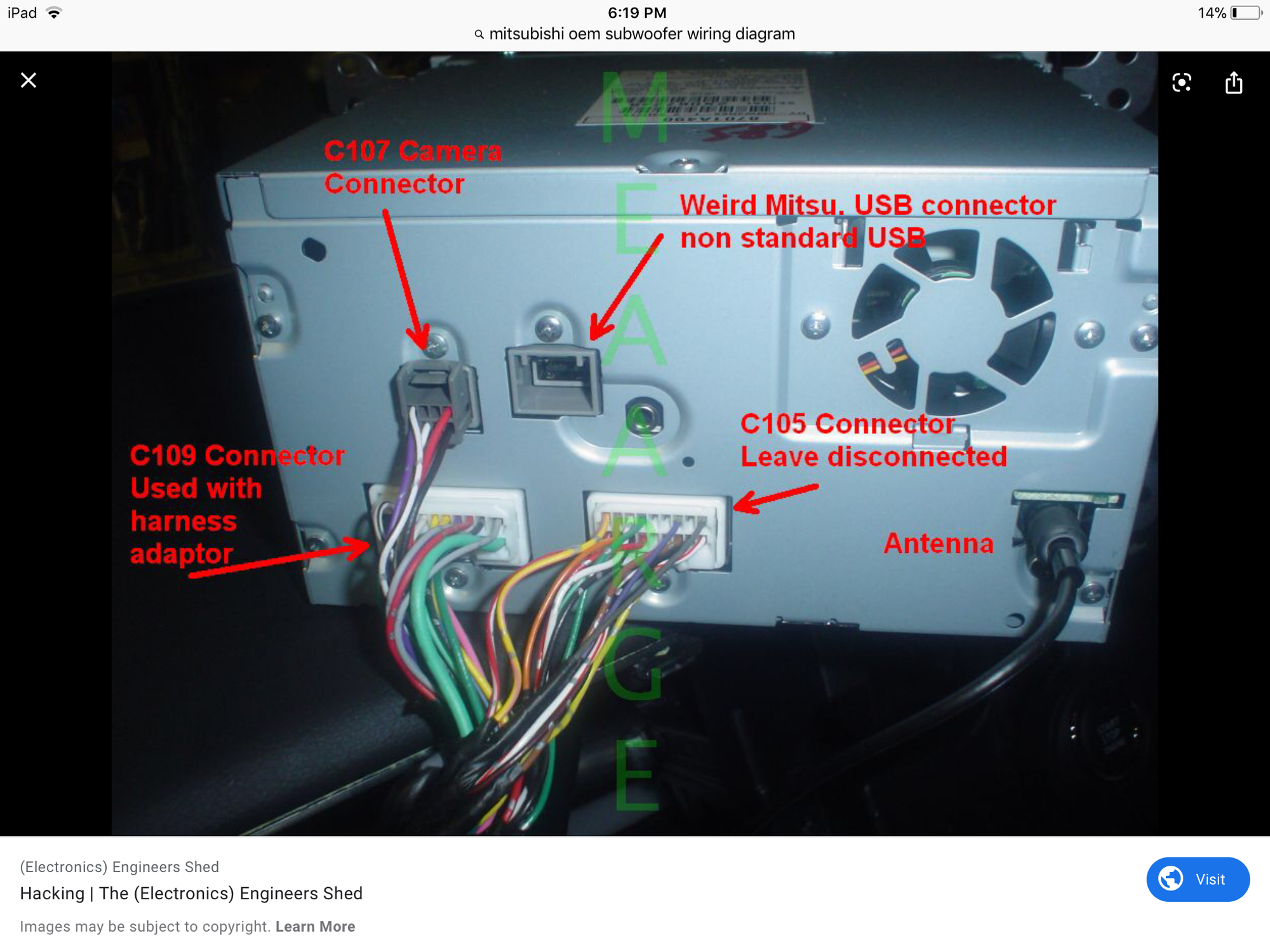

I have a Lancer DE 2014, when I purchased I installed a non nav touchscreen radio from an Outlander, I would like to add Bluetooth module but, I only saw the 20 pin connector for the radio and USB plug. There was no connector 18 pin connector, also behind glove compartment I also did not see the plug to connect the Bluetooth module which is secured in blue tape as mentioned in other posts. I don’t have the button steering wheel. Is it still possible to install the OEM module in my car? And if so what do I need. The GROM system is not compatible either. I see in secret menu on radio the hands free option not highlighted because it’s not there. I have a little experience with electrical because I was able to install a aftermarket reverse cámara without the plug. Please advise!

Realicé ese montaje hace un tiempo en mi Lancer 2013, se necesita el módulo Bluetooth compatible con tu radio, el ramal y cableado del módulo Bluetooth, el micrófono que va en el techo( en la luz de cortesía) y el control al volante.
Algo más menos así
