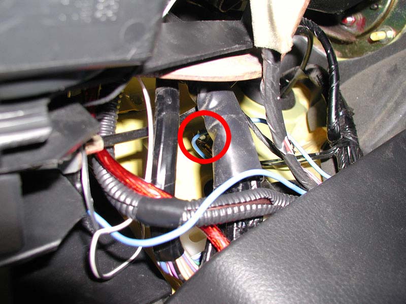

i removed the center console and disconnected all the wires and lightbulbs in there. i had an idea not just to hide the wire and leave the 12V connector exposed but to splice the wire from the radar detector directly into the wires that power my 12V outlet. time to get crazy.
this brought up a few problems:
1. making sure i got the POS and NEG right (which i didn't--more on this later).
2. adding a fuse to the line.
3. hiding the fuse as well.
4. hiding the additional wiring.
first off i set out to do a test as to whether i could actually power the radar detector off of the spliced wires. this was a catastrophic failure as i did NOT make note of which wire was POS and which wire was NEG... i wired everything up and got some water and took a five minute break. in that time i'd forgot which wire was which and when i cranked the electrical on... *POP* *HISS* and the thing started pouring out smoke. what a newbie mistake. i couldn't believe i actually did this. worst of all was that i didn't put a fuse and holder into the line yet so my unit was pretty much toast.
so with that taken care of i ran out and bought a new radar detector. there were cordless models at my walmart... but they were all ugly and i was determined to finish my original project. down to business.

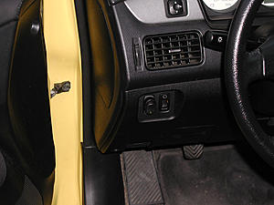

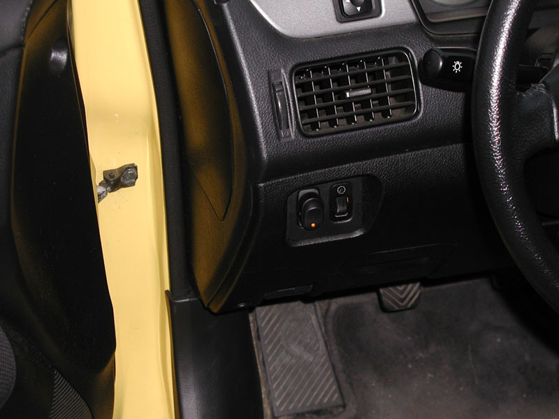

what i did was i spliced a fuse holder into my POS wire and i ran that to a $6 switch with an amber LED that i picked up at the local advance auto parts. the switch had input, output, and ground for the LED. i ran the ground wire to an already existing grounding point that
had made. from there i popped out the little plastic placeholder next to my dimmer and drilled a hole in it. i mounted the switch to the placeholder and that was that.
finally i reconnected everything and gave it a try now that it was CORRECTLY wired... success! there's a few inches of wire visible before the new wire disappears under my dash. from there it runs under panels and under my steering column into the center column where it is spliced into the 12V. the switch lights up yellow (to match the car!) when it is activated and it works perfectly to shut off the detector with a flick of my finger.

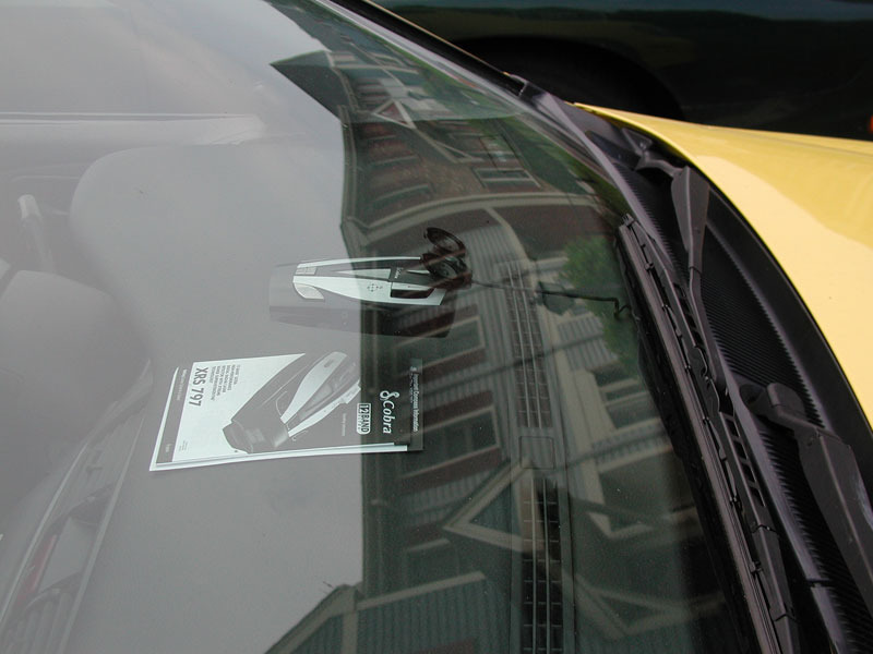

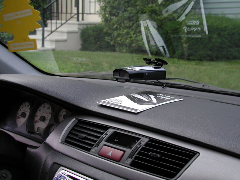

very clean. Just a note for future radar detector use though they work better the higher up on the windshield you put them, thats why most guys wire them from the top down.

It seems so much effort what you did. I used the factory radar plug, cut the wire, and extended it. I spliced it into my accessory wires of the radio, so when the car turns on, the radar turns on. If I want to switch it off I just push the button on the Radar.....
Lower is good for laser (ie using the guns) Higher can detect other things. Although I didn't notice much of a difference when I moved it around and kept on heading towards one of those speed checkers.
