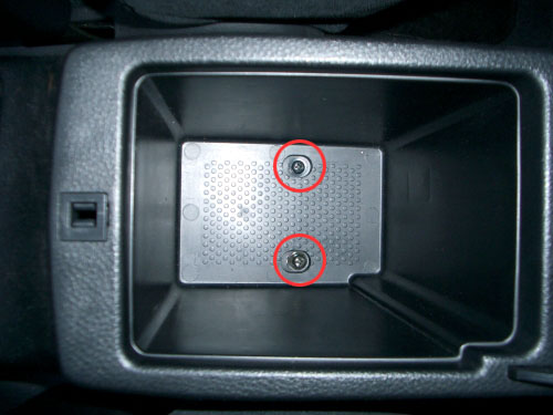

Old Mar 5, 2004 | 04:38 PM
jtc's Avatar
jtc
Posts: 332
From: Toronto, Canada
Begin at the center box (armrest). Unscrew the two screws holding the box down, and pull the whole unit from the back up, releasing it from the two clips at the front.

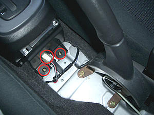

Old Mar 5, 2004 | 04:42 PM
jtc's Avatar
jtc
Posts: 332

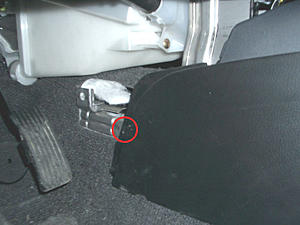

Now to the left lower part, beside the pedals. Using your screwdriver, unscrew the plastic screw holding the panel in, and pry away the panel. It has tabs that attach it to the center console.

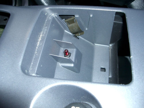

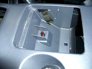

Old Mar 5, 2004 | 04:48 PM
jtc's Avatar
jtc
Posts: 332
To change the bulb in the ashtray, remove the ashtray and replace with desired bulb colour. This is the bulb that lights the ashtray when the ashtray is open.

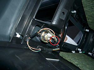

Old Mar 5, 2004 | 04:50 PM
jtc's Avatar
jtc
Posts: 332
Flip over the center console. You'll see the cigarette lighter assembly, the circled item is the bulb you want to replace.

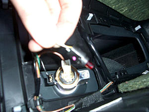

Old Mar 5, 2004 | 04:51 PM
jtc's Avatar
jtc
Posts: 332
Bulb unscrewed, replaced. Now put it back.

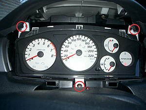

Moving on to the gauge cluster and clock mod, first remove the two screws holding in the top of the gauge cluster.
Old Mar 5, 2004 | 04:55 PM
jtc's Avatar
jtc
Posts: 332
Next, remove the 3 screws holding the gauge cluster in place.

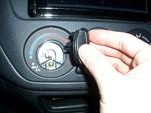

With the gauge cluster loose, pull it slightly out of its sitting place. Now on to the climate controls. Twist all knobs all the way to the left, this makes it easier to put them back in later. Simply pull them out.
