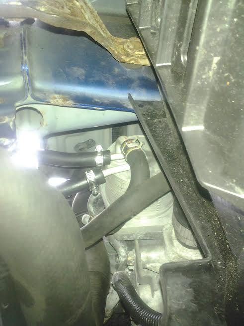

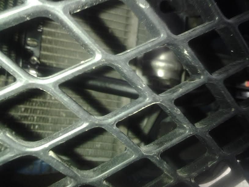

My Trans oil cooler became corroded and started leaking. I noticed the location is right in from of the Drivers side front tired. How stupid! I laughed at the price of a new one for 372 Dollars (Why? so this happens again and again). I bought the Hayden # 678 for 52.00 dollars at ROCK AUTO. There's not much fluid in the OEM trans cooler when you take it off, just keep a drain pan underneath. I had to take the front Bumper off to do this job (there are youtube videos fyi), since I took the bumper off I did a Coolant Change and a Transmission change while I was at it. Just take your time slowly taking off the rubber hoses and clamps, don't rush because you don't want to bend where the hoses attach. The way I mounted my Hayden #678 I had more than enough hose and I snugged the clamps. When I started the car I just kept tightening the clamps until the fluid stopped leaking and tightened the clamp just a little more, you don't have to crank on them. I think it took me almost 2 hours because I took my time and I switched the hoses from, "underneath for certain reasons" instead of taking the battery and battery holder off. Please view the photos below. Thanks.

The hayden is a radiator only right? Where do I get the actual oil assembly to change out from my 09 lancer es? I would prefer a cheaper alternative than OEM.

This is an oil transmission cooler and looks like a mini radiator sort of speak.
Amazon.com: Hayden Automotive 678 Rapid-Cool Plate and Fin Transmission Cooler: Automotive Amazon.com: Hayden Automotive 678 Rapid-Cool Plate and Fin Transmission Cooler: Automotive
This is a radiator from Rock Auto.com, this is for the 2.4L Engine, go to the website and check them out, they deliver.
https://www.rockauto.com/catalog/mor...nid=433&jpid=4
