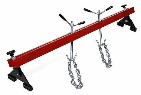

This is the SST I am referring to:
While I really don't want to spend any more $, I think I might need to breakdown and get one of these....
Of these 2, which is better?
The 1st one, doesn't look like it has adjustable sides, but it does have a 3rd support.....
the 2nd one, is just the 2 side supports.
I did find an 02 Automatic lancer video on youtube. Where this user uses one like the 2nd version, the 2 point one. Doesn't even look like he is one the actual strut towers, but more of the fender lip line

I used the top one, cheap to buy on amazon, plenty strong enough. The hook is adjustable up and down by turning the nut and it has enough range. The leg opposite the hook, with the rubber foot on it, rests on the frame cross-member beside the top of the radiator.
It supported the engine okay, and allowed the engine to be let down a bit as needed to help get the tranny out.
