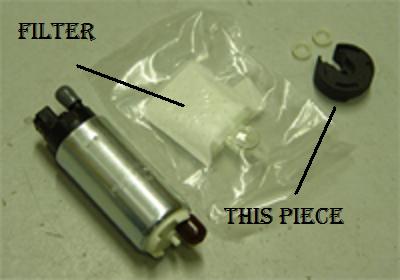

wipe it off yes, and spray inside the hole it came out of.... you really need to get your hands on a multimeter.
and you dont have what ? the black thing pushing up on the pump ? if not, it may not be black... there should be a rubber thing that pushes up on the bottom of your pump when you close the plastic shell around it
