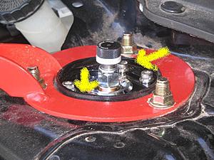

Originally Posted by Blacksheepdj
Depends. Some coilovers come with camber plates. If you get those, you don't need the camber bolts. But if you get a kit that just has standard tophats, you definitely want camber bolts.
As for modifying the bolts everytime you change ride height . . . sorta. Every time you change the ride height of the car, you will be altering the alignment. At the same time, unless you have an alignment rack at your house, you wouldn't know HOW to modify the bolts. The basic answer is this - if you want to be safe and smart, get an alignment everytime you change the ride height.
Thanks a lot for the answer blacksheep. I'll make sure I get those kind of coilovers. Hope the megan racing coilovers that are coming up have these camber plates.

Well actually could someone tell me if possible from the pictures in this thread https://www.evolutionm.net/forums/sh...d.php?t=314928 if these coilovers come with camber plates.

Yeah, those Megan Coilovers do come with Camber Plates. Those are the extra bolts on the top of the Strut mount. Should be relatively easy to do a good alignment on your car after installation with those.
Save you the hassle of having to put in Camber bolts.

For those new to this, a picture...
The arrows point to the screws that hold the camber plates in place.
