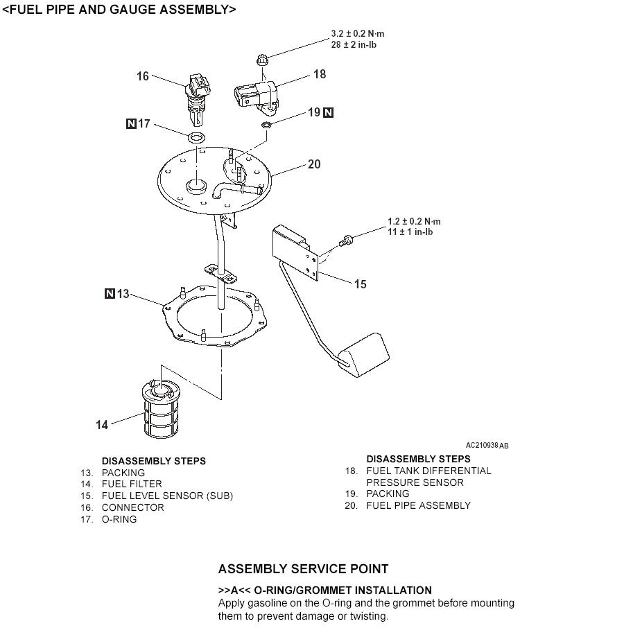

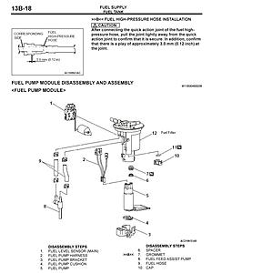

The fuel filter is located right on top of the fuel pump which is located under the rear seats. Not sure how to attach pics.

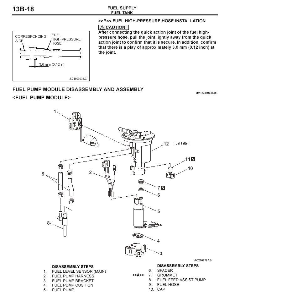

More diagram

What the hell is that first pic from? Having actually pulled the fuel pump out it is definitely exactly like the 2nd pic. I assumed that the filter is the mesh bag looking thing on the end of the pump. Maybe not. Im confused now.

Don't worry about pic1. That one goes into the gas tank which also has a filter.
Pic2 with the fuel pump is where you would want to replace the fuel filter (not sure what it looks like).
