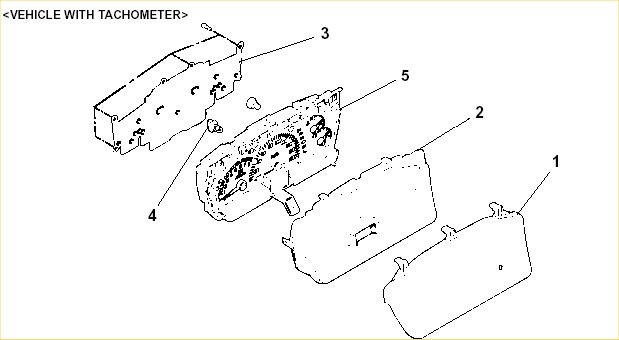

hey guys whats up,
3 there are two philips screws on your dash, there up underneth, take thoes out
4 take the outside trim piece off, it just snaps in
5 remove the gold 3 screws that hold the gauges in, be careful not to scratch the plastic
6 remove and unplug the gauge cluster *you will have to play with the cluster to get it out, be careful not to scratch anything*
7 the "glass" is snaped in, all you have to do is snap it off, its pretty easy.
8 installation is reverse
i hope this helps, just be careful, but if you blow something or you car catches on fire its not my fault =)
