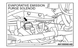

This is what it looks like:
This is where it is (location C):
Thanks for your reply, i have checked that information on alldata already and have checked on the car aswell, and everything on that Area looks pretty Good, so i dont think there is the problem, will take some pictures tomorrow so you can se wich hose i mean.
