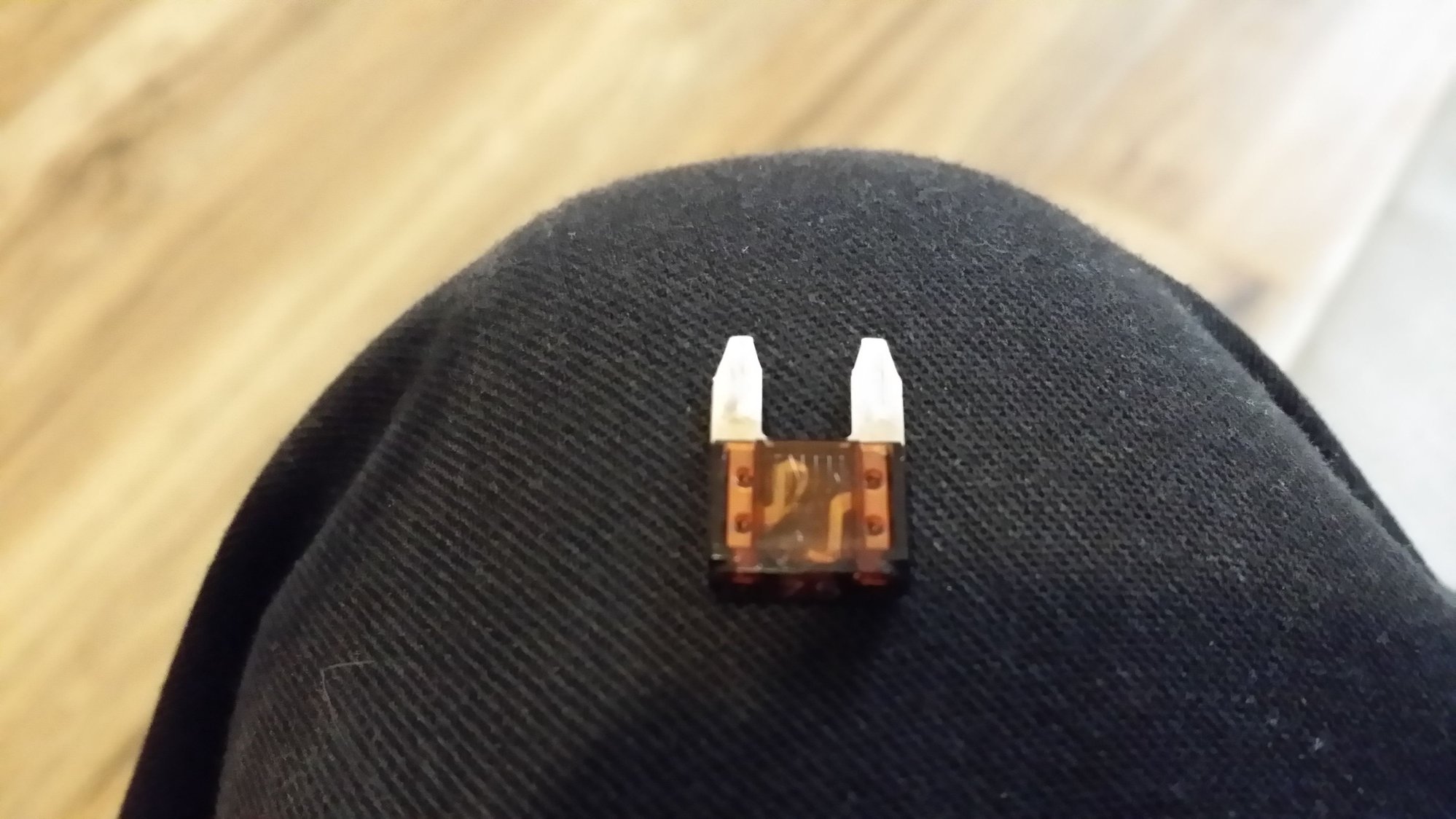

By the way guys stay tuned for the results of the 7.5 fuse. Haven't got a chance to go buy a pack of replacements fuses yet

Fuse #8 under the dash (7.5A brown) energizes the coils of the fuel pump relays when the ignition switch is turned on...Fuse #15 (15A blue) under the hood, provides power directly to the fuel pump and fuel level sensor. When I reply to threads, I generally assume the person has checked the fuses before posting on the forum, good luck!
also I have the entire factory service manual...comes in handy when you start chasing wiring faults

Thanks I really appreciate that clarification on the fuses! Right on point! Well because the car would not start right after my working on it I thought it was directly related to the work I had performed which was the exhaust so fuses were the last thing on my mind at the time I posted. I was really looking for some opinions about the backpressure. After a comment confirming what I was already thinking(that the car should at least start with the silenser) then I started thinking the problem was not exhaust related and had nothing to do with the work I performed. After paying the $822 at Goodyear another auto repair shop was the last thing on my mind lol joke. So that's what lead me to check other basic funtions and hence the pump/electrict and hense the fuses . Do you have pic of your Lancer you like to share? I'm interested
