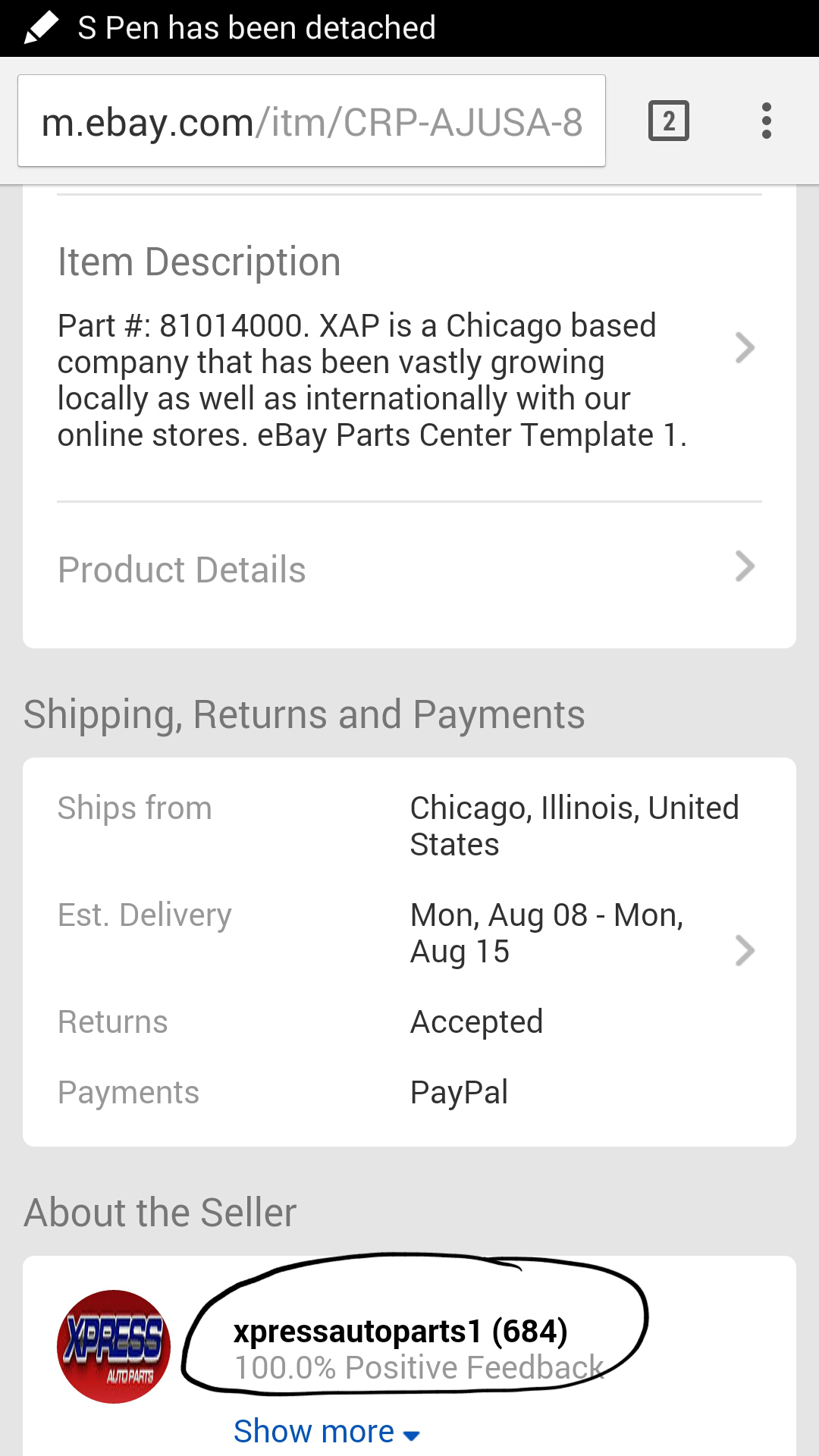

Ok guys so I found a pretty good deal on some head bolts here less than $20 and free shipping. Now on this particular item it doesn't say what vehicle it fits, but it has the same item number that the other ones had I showed you guys. When I placed the order I left a note for the company asking if they would please verify these bolts will fit an 02 Mitsubishi Lancer 2.0. According to the shipping information they normally ship the item the next day so maybe they will reply tomorrow

Ok so this company also has a 100% feedback . It makes me feel better seeing the feedback rating at least in the 90s lol but 100 is better. Oh and check it out guts they only have 1 set left now because I just bought 1 of 2 haha . Hope this is a sign of more positive things to come with this Lancer
