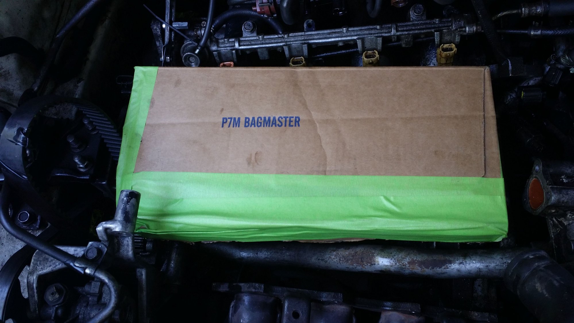

Oh and BTW in case you're wondering yes a made a shield cover to protect all my cleaning and prep work until time to install the new gasket
