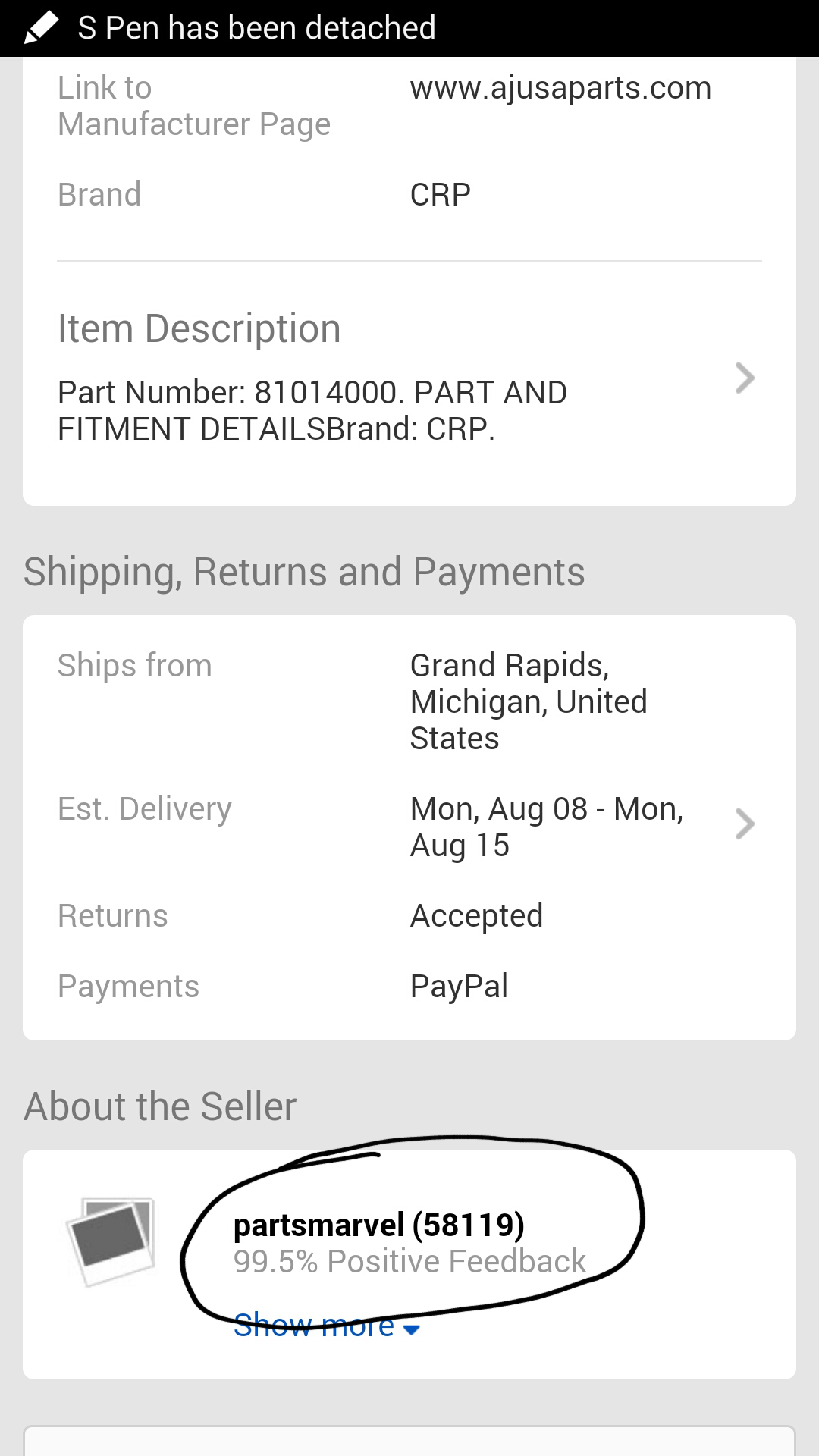

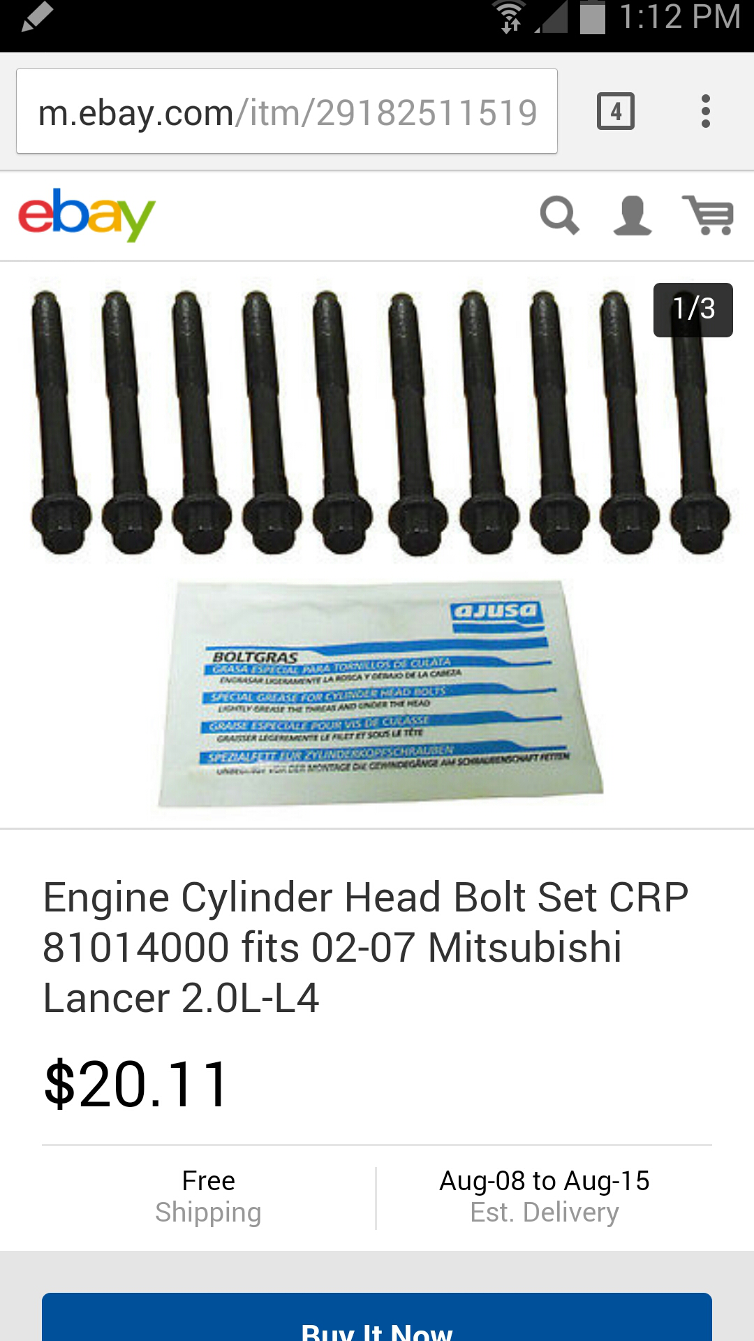

I found these here in the pic(if it's showing) with free shipping and almost a 100% feedback rating

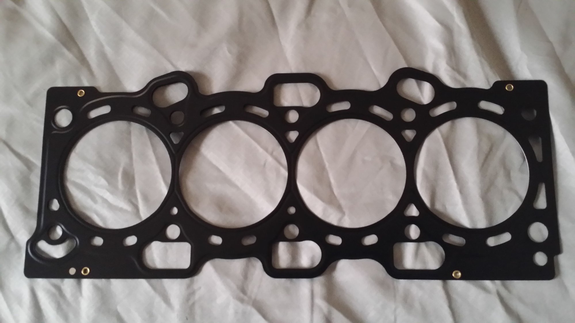

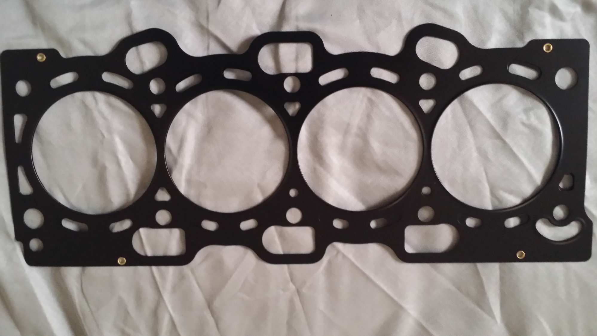

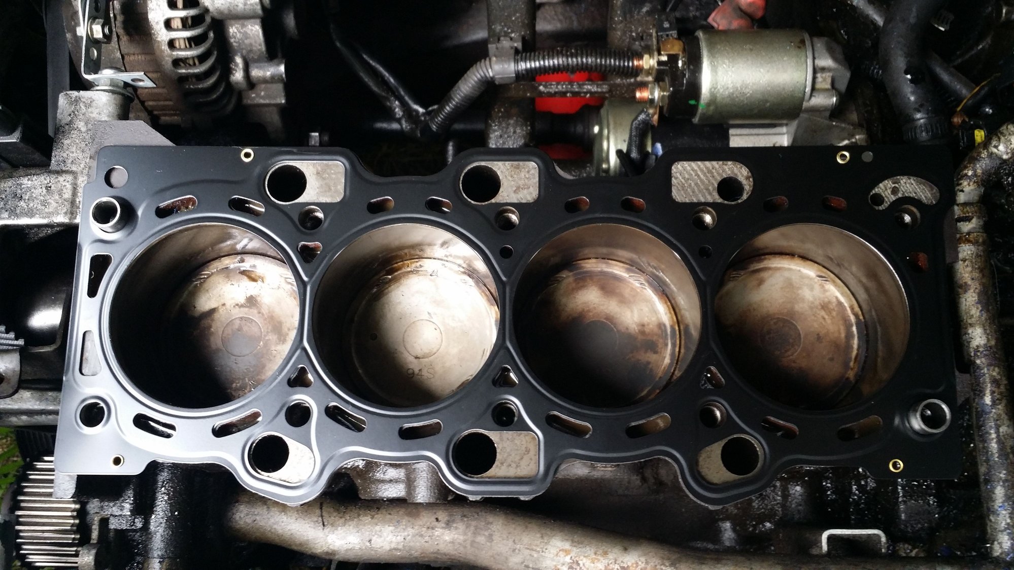

Ok guys hope you all are well . I can see why the DomesticGaskets company has a 100% feedback rating because they certainly delivered on their service. The gasket came today, here's the pics:

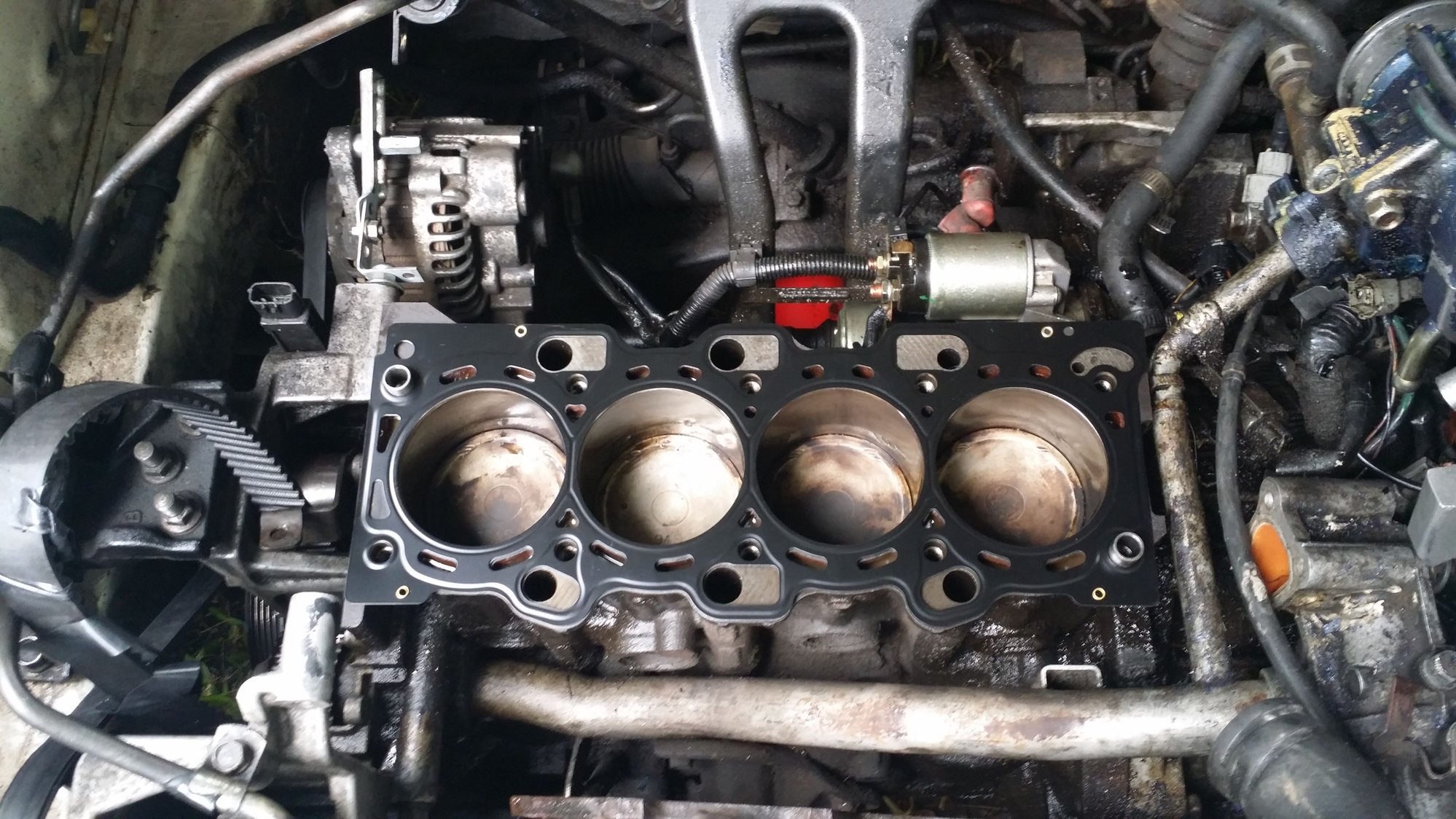

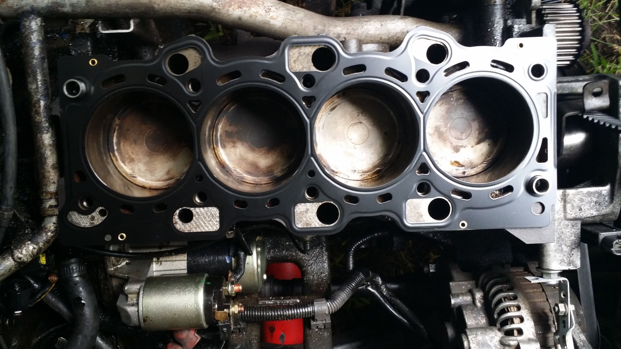

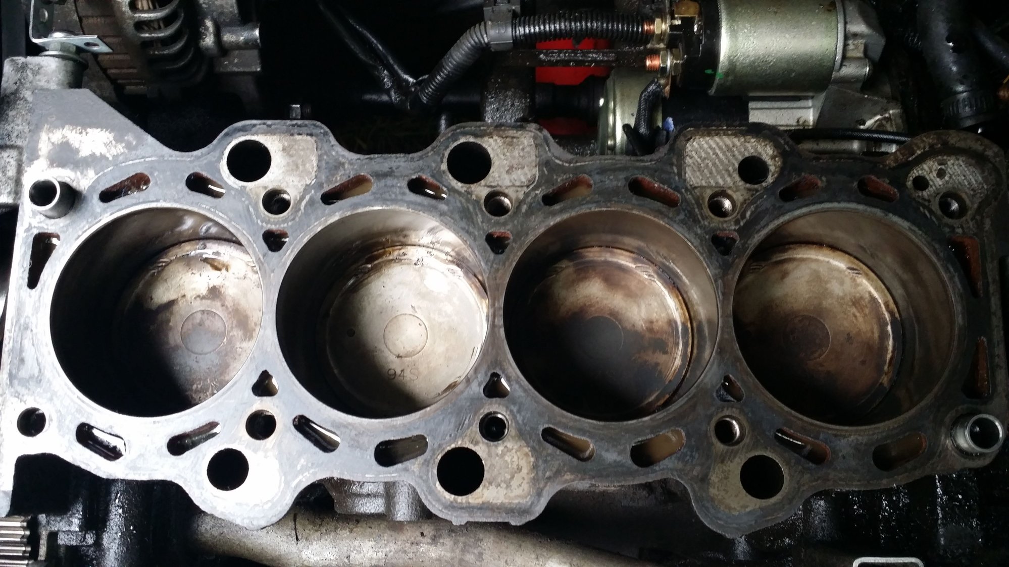

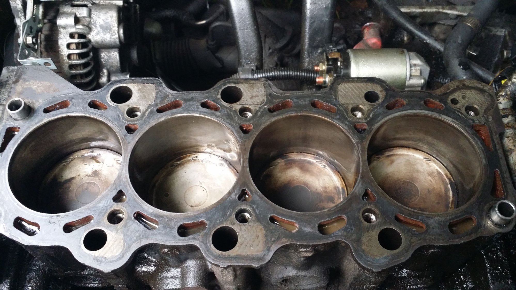

So before I put the gasket on, I did one last prep job on the block gasket surface, and cleaned debri from the bolt holes and the coolant holes and the oil holes, and also it was suggested to rub a little oil inside the piston well walls so it wont have a ruff start. So that's all done and the gasket has been placed. Please see the following pics

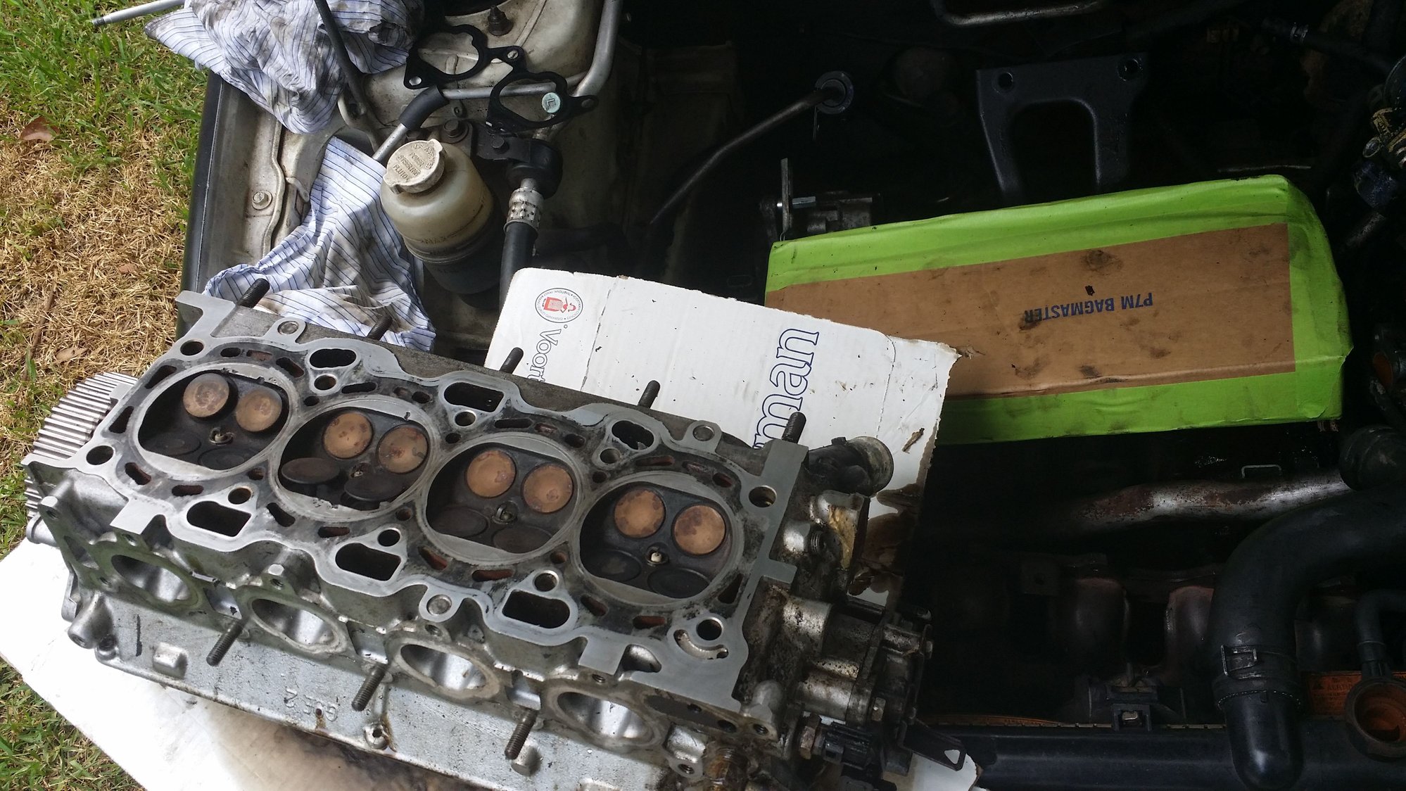

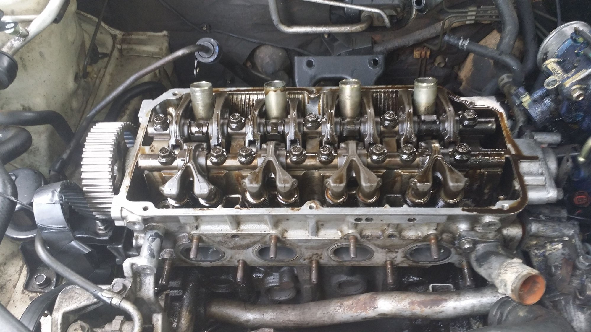

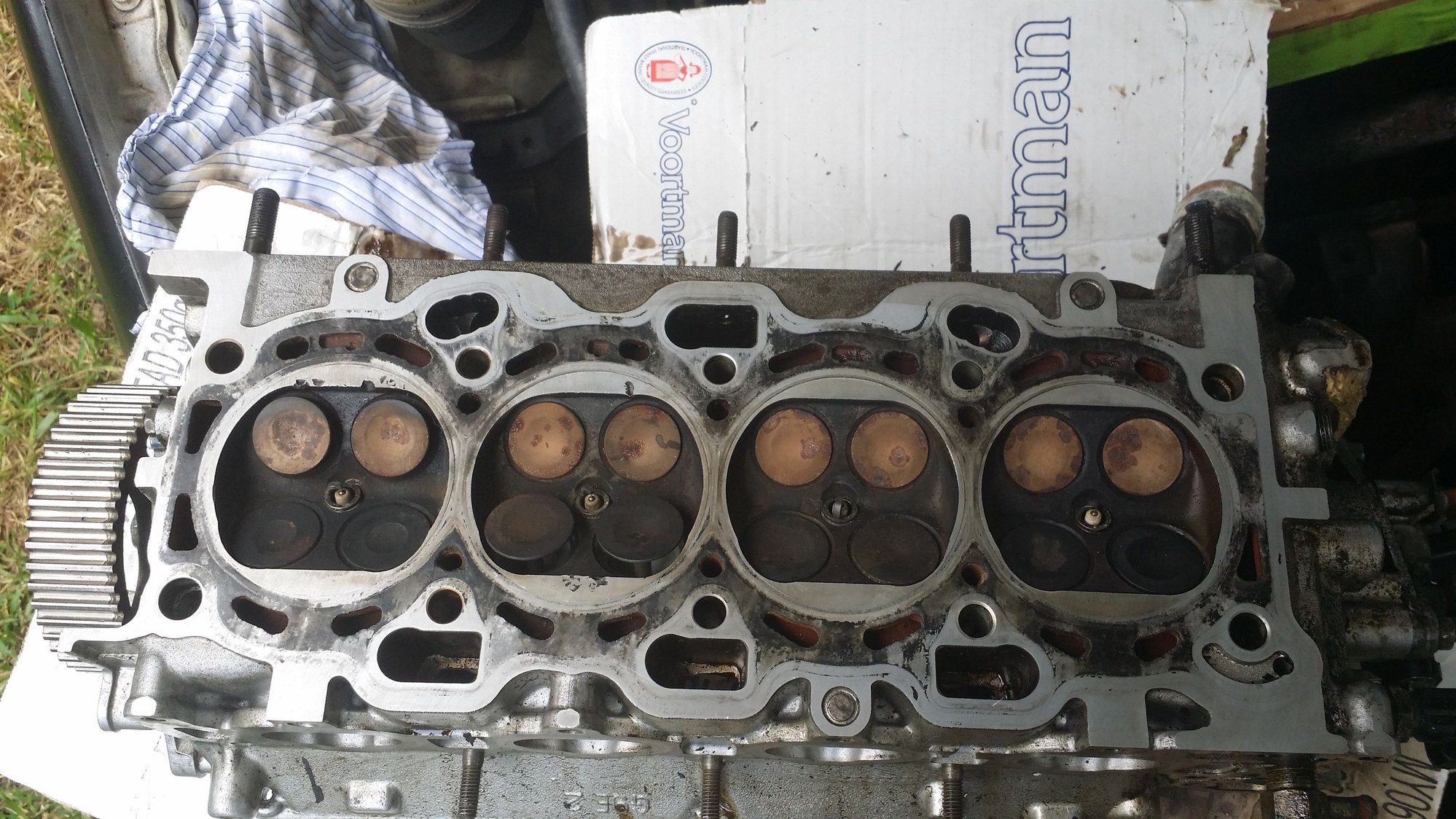

Ok guys so this is after a thorough cleaning and prep of the head gasket surface. I used brake cleaner to wide away all the oil. Next a I used a razor blade to scrape off the old gasket residue and blew out the debri. Next I proceeded with the scotch pad and repeated the process. I noticed the coolant passages were constricted by corrosion. I used a kind of pick tool to mind out and remove the corrosion. I cleaned out the oil passages. I turned the head back up and shook it to shake out all the deri I scraped up from the previous process. So lastly I soaked a rag with brake cleaner and gave one final wipe off/out and that's when I took the pics above

So here we are hehehe, back up right. No new head bolts yet but about to order them soon. I'm out for now guys I'll update/reply soon and all comments negative/positive appreciated cheers!

Great job. I'm a bit worried about the corrosion on the head, if it gets worse then it will allow the coolant to get into the cylinders and kill the engine. I marked the areas in red, maybe experts can chime in if its a major concern

Oh yes thanks for bringing up those areas you have marked bro, umm lets see...If I'm not mistaken as I examined those marks they looked like actual nicks/chips. I'm not sure how to describe it. The best way I can say it is it looks like someone removed the head and bumped hard on something and it caused the nicks or marks(it wasn't me by the way lol) . This brings me to mention something else guys. Ok the head must have been removed before. Yeah that's right I remember standing in the yard checking out the car with the latest previous owner and we said the timing belt broke and he got someone to do the piston job because of damage from the timing snap. Ok so maybe those nicks you have circled came from a previous mechanic(maybe not certified) that did the internal engine work and maybe he bumped the head against something. And or had the head resurfaced (maybe did it himself) and it got nicked during the resurface work. Lots of questions but I guess we'll never know guys. Like did they change the head gasket or reuse the same one? Did they use a torque wrench for proper tightening specs on the head bolts? Or better yet did they reuse the old head bolts? Wow lots of good questions I wish I was more entuned to asking in the heat and excitement of the moment
