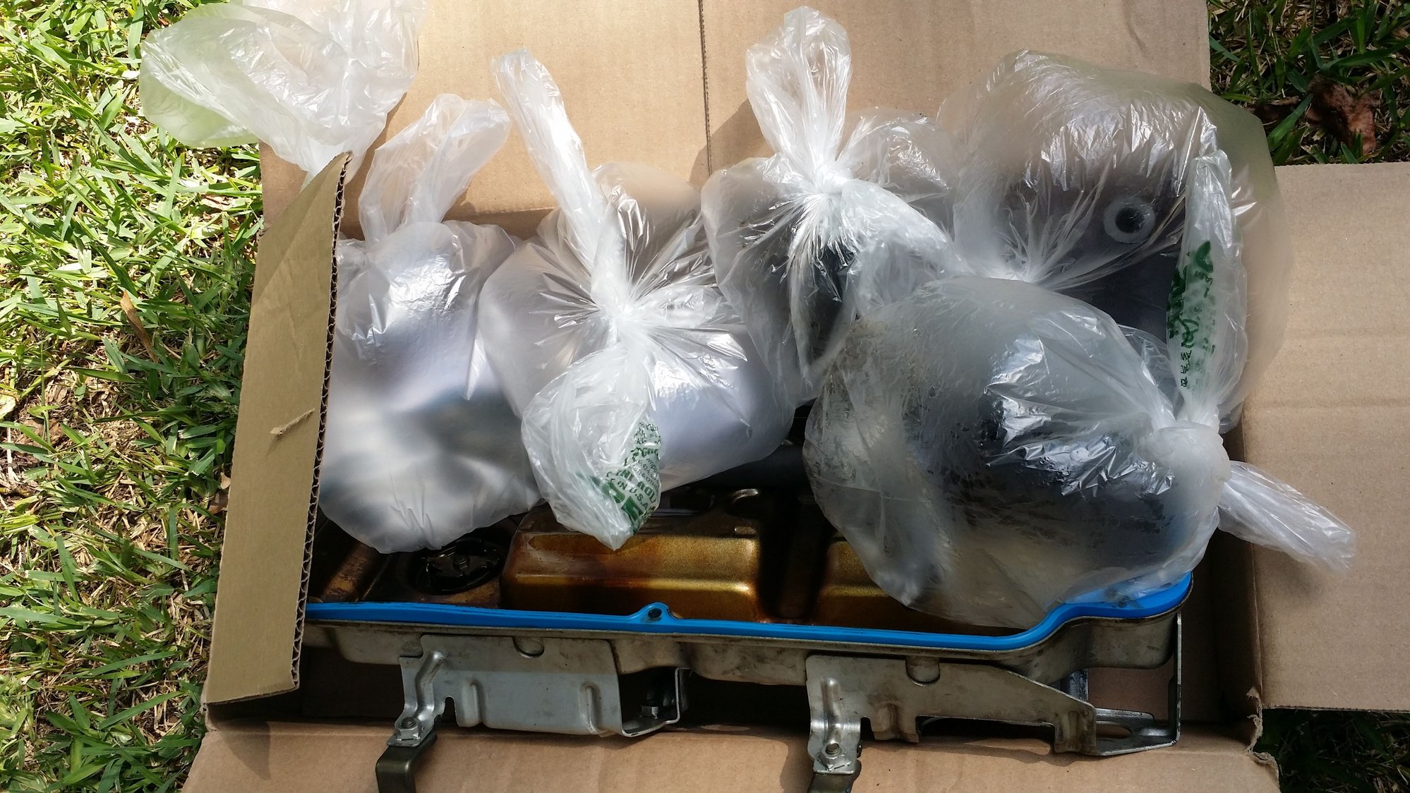

Trying to do this thing right, got all the small stuff in bags and labeled
Hmmm....might be a good time to upgrade that ghetto short ram LOL

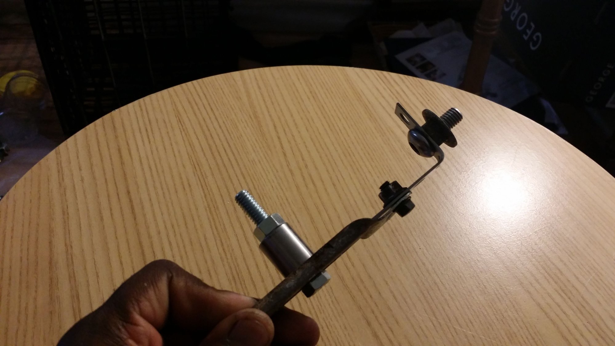

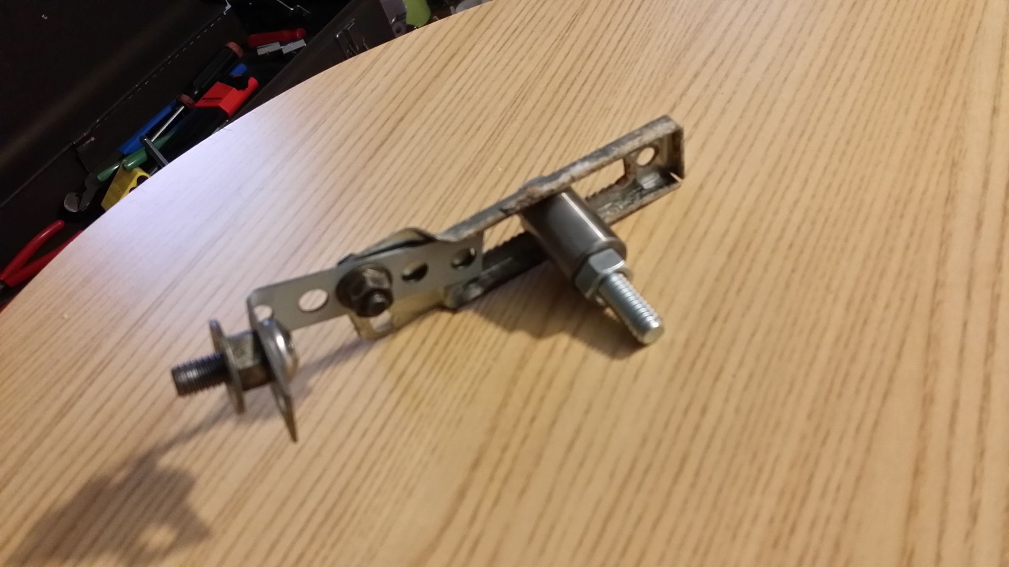

No tension adjuster before wow scary

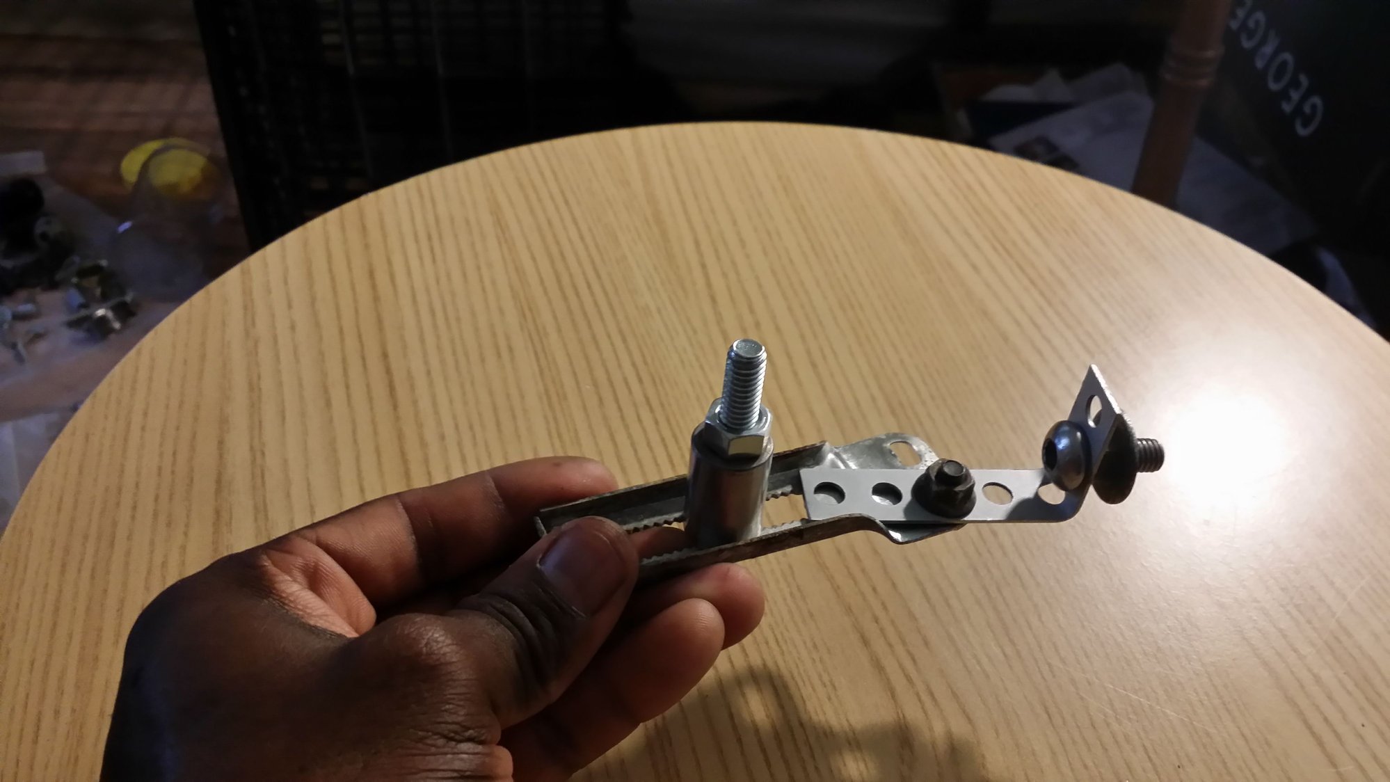

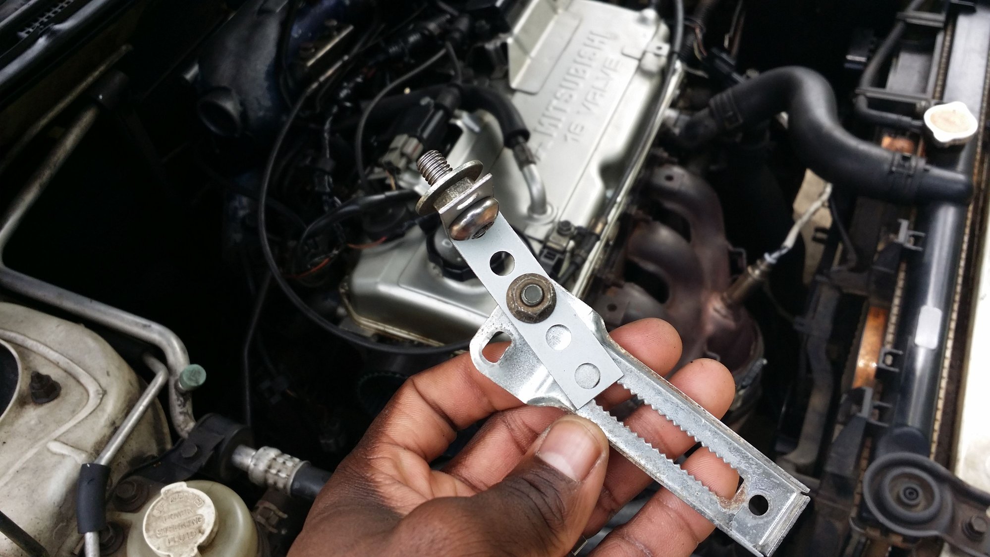

My DIY fix
My DIY fix

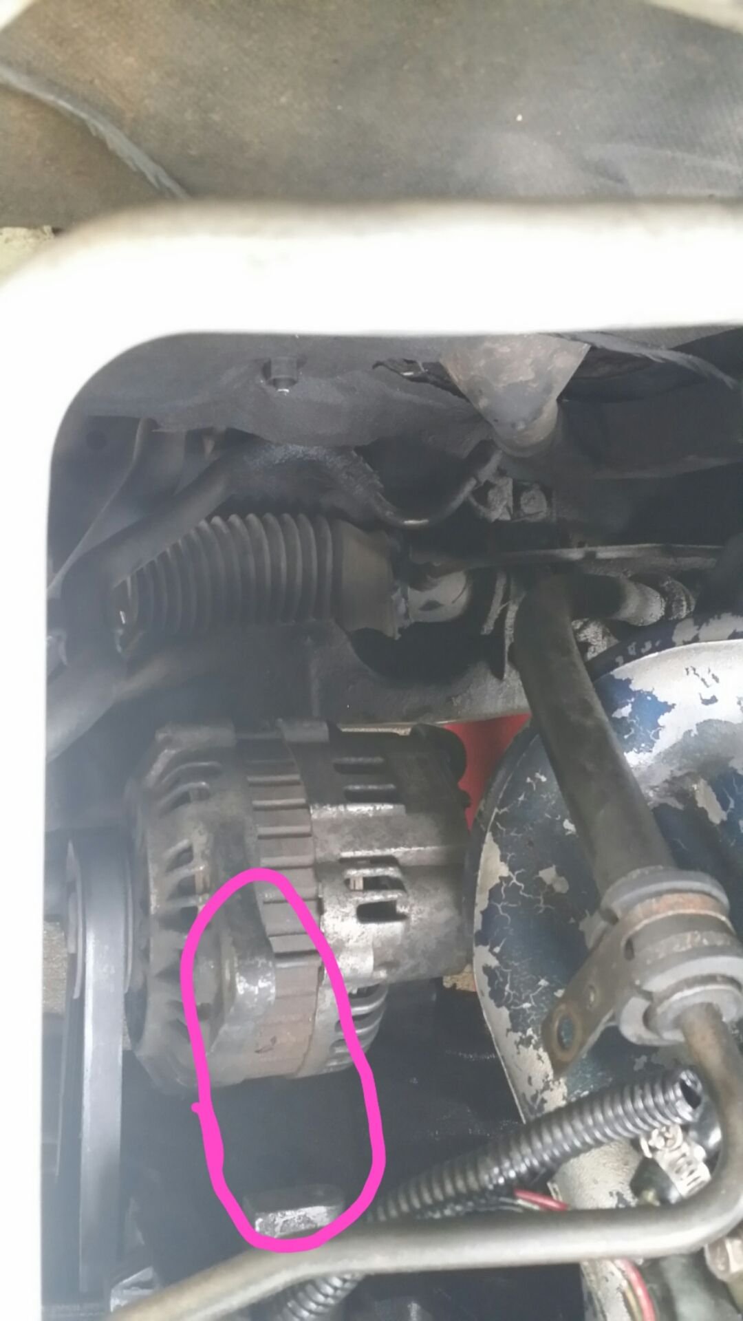

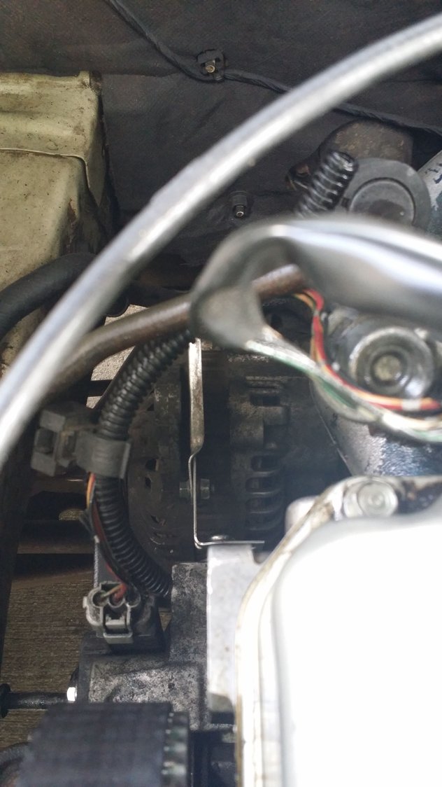

Old Jul 22, 2016 | 06:09 PM

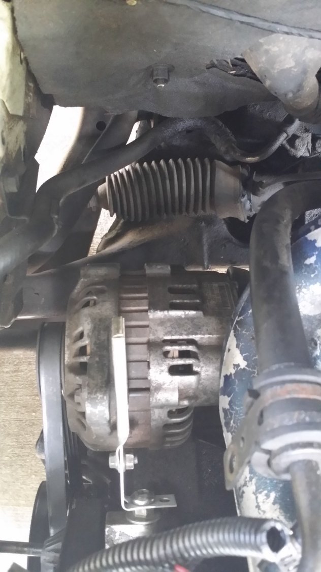

Had make a few more adjustments before it would work lol but it's on there now haha

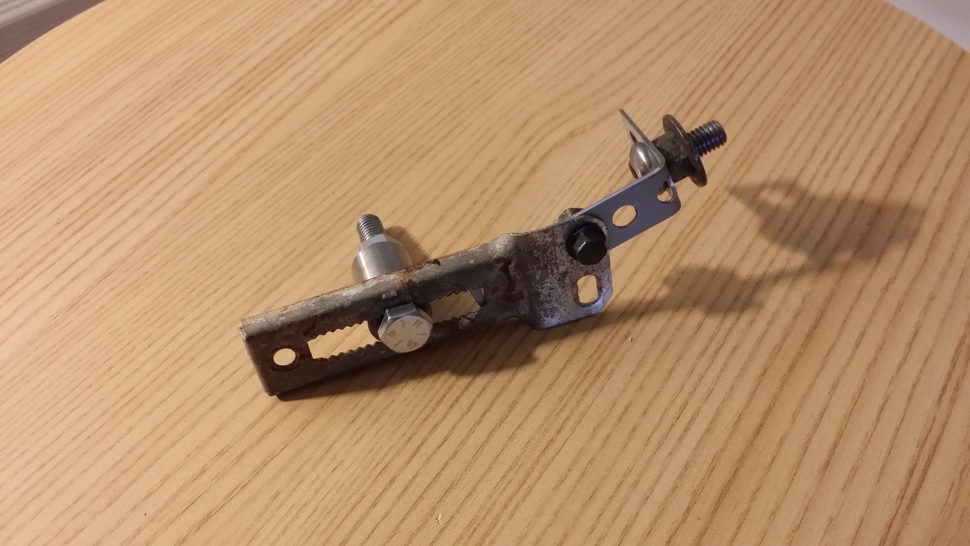

I tried to clean it up really good with steel wool, but what I really want to do is paint it black. All in due time
I've really got to hand it to you, you're rather crafty with fabricating a quick fix. I hope that holds up like it should. I can't remember what you need to get that piece off, but I would look around for a replacement for it. The alternator belt gets a good bit of tension when it's up there right. I don't know that those thin pieces will hold it right for long.
It's been a while since I've had my 03 lancer, so I can't quite remember how the tension arm goes in, but if it's tensile, that should last as long as the metal does, a compressive load may cause it to bend or bow...
Old Jul 23, 2016 | 10:38 AM
  #119
CJBarker2's Avatar
Joined: Mar 2016
Posts: 96
Likes: 29
From: SC
It's a compressive load. The bolt that tightens up the alternator pushes on the arm that hangs off of the motor and pulls the alternator by a square block that is bolted to the alternator through a groove that runs down the length of the arm. When you loosen up the alternator, it swings up and in, and vice versa. I had a lot of trouble with mine last year. Previous owner had put a jam nut on the end of a stud to put there. Threads were flattened around that stud for a good inch, which kept me from getting the right amount of tension on the belt. Real PITA.
