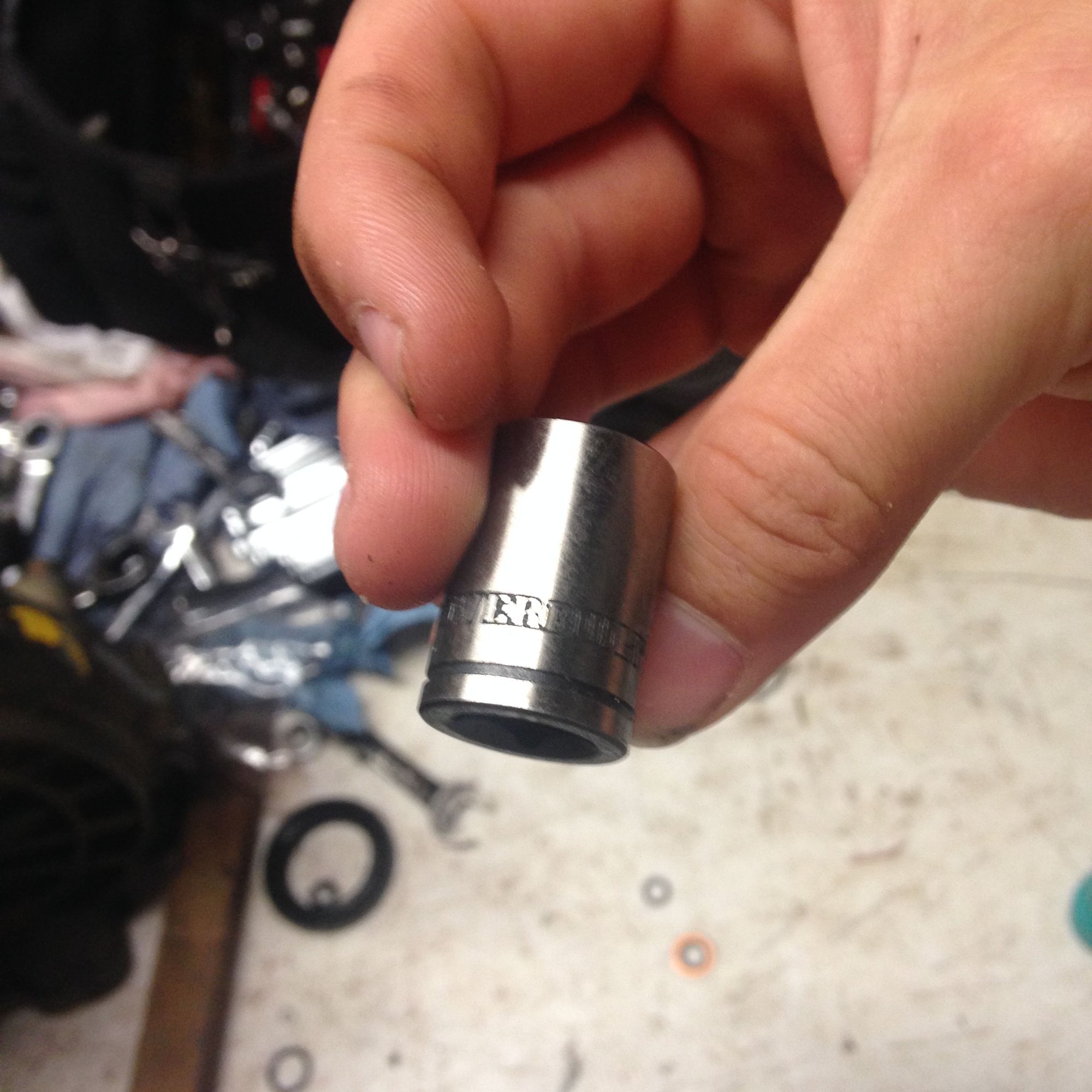

I made a mistake, man. That's a 10-mm star, which is also called a 10-mm 12-point socket. When you pull the valve cover off, down between the rocker arms on either side are the head bolts. They're black and look splined. I found a multi-socket set at O'Reilly's a while back that I use all the time. It's 6 or 7 sockets and they fit around metric and standard sockets. I bought them for the head bolts in particular because I'd planned to pull a head last year. That set is the best thing I have ever bought for working in this car. I'll take a picture of the 10mm/3/8" that I have on-hand and attach it in a post once I get back out to my tools. You'll find them to be wonderful for when you're in a pinch or when you can't carry a big toolbox.

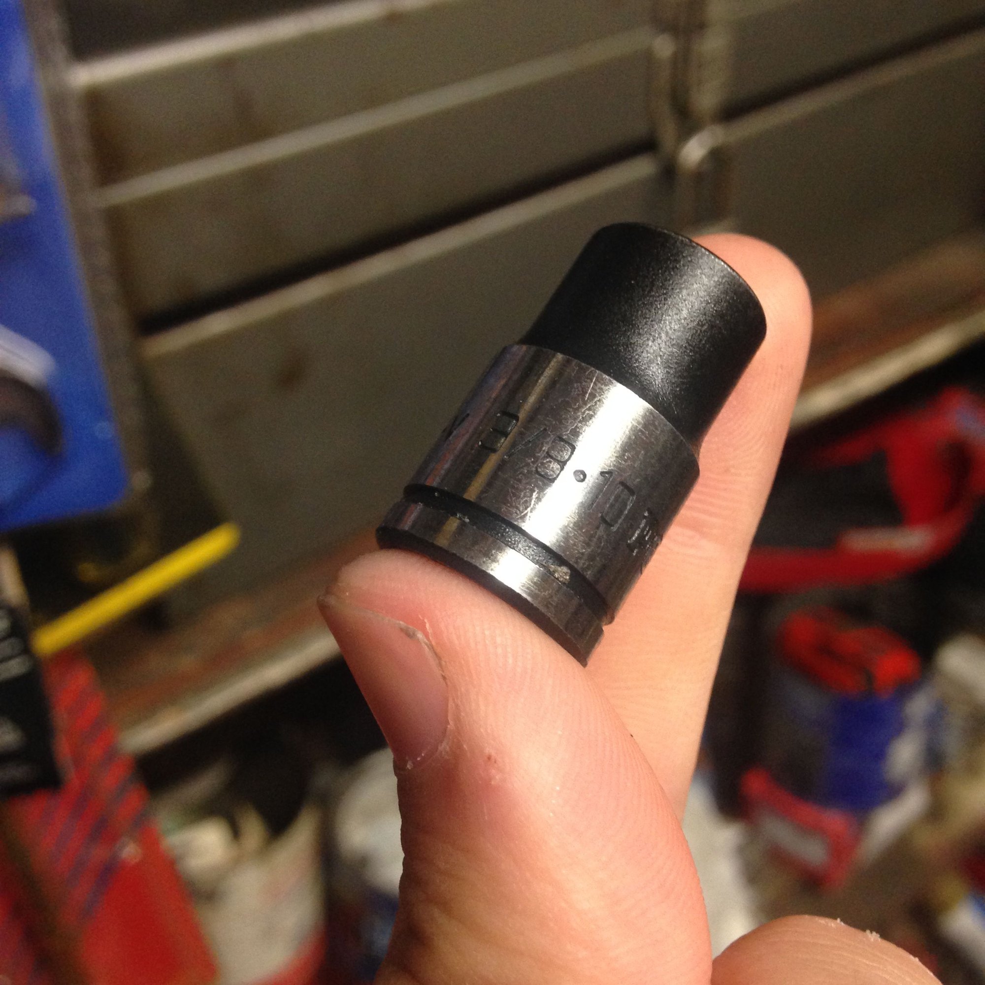

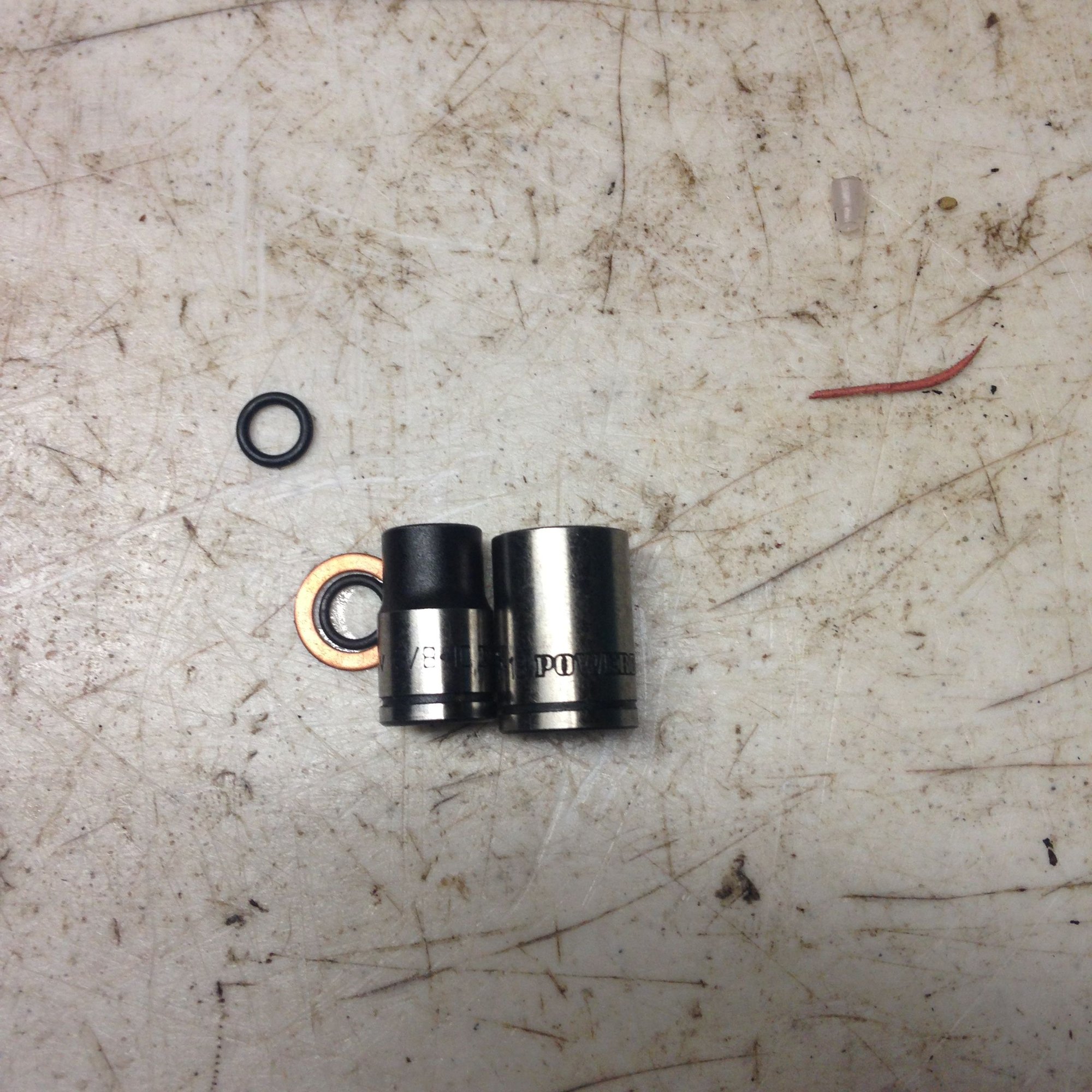

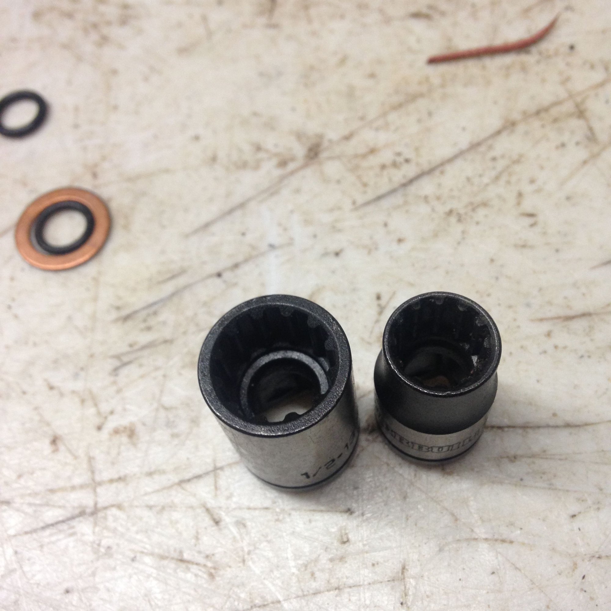

I found the sockets. They're a brand called "powerbuilt," and they're sold in O'Reilly's stores. They're CR-V (chrome-vanadium) sockets, and they're slotted rather than being cut for 6 or 12 points. I have tried them on rounded bolts as well as good ones, and they turn them all like they're brand new. By far the most useful socket set I own (and can't find all of.)
Pictures are attached. The package looked cheap (and it was.)

Those sockets are not for removing stripped bolts, there are actually bolts that are splined and that's what those are for...head bolts are 12 point.

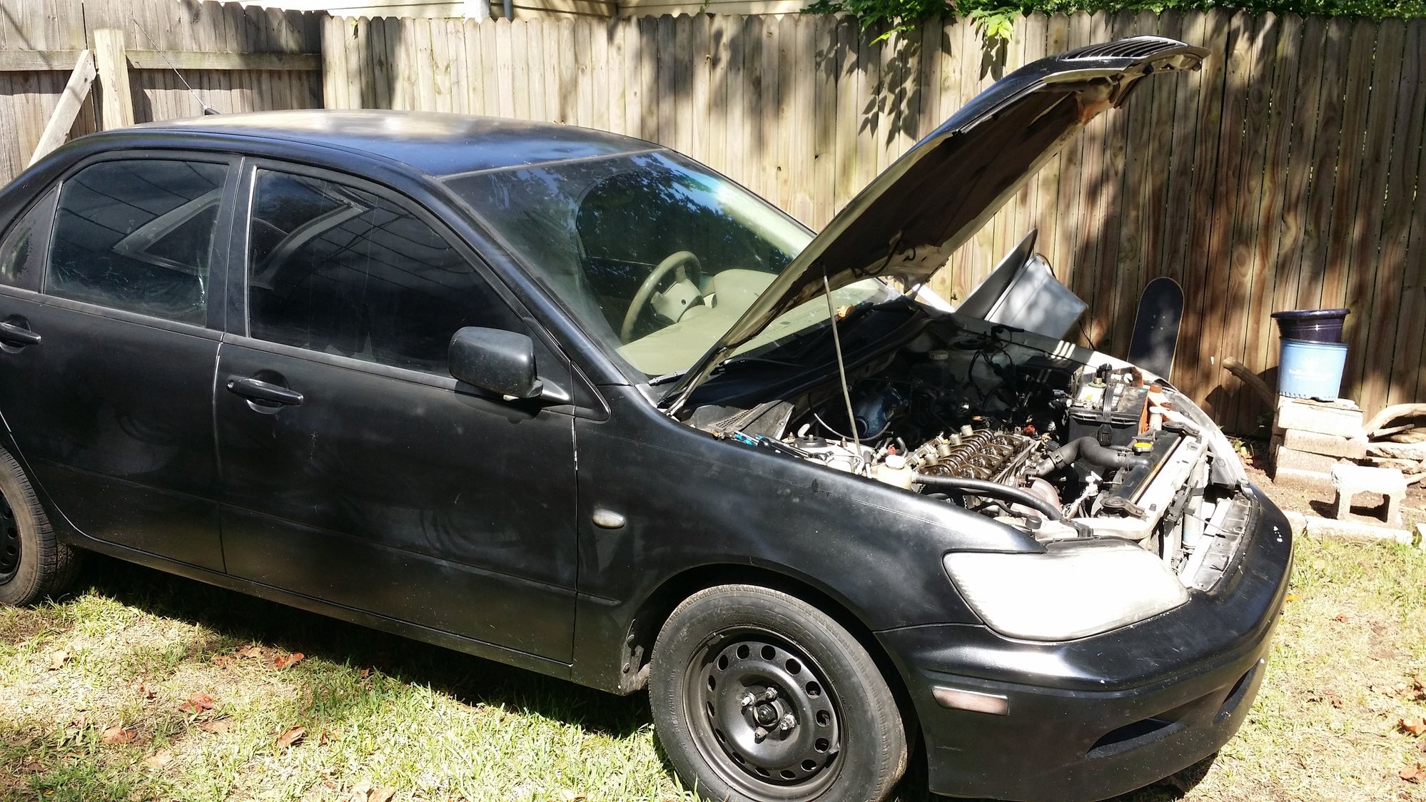

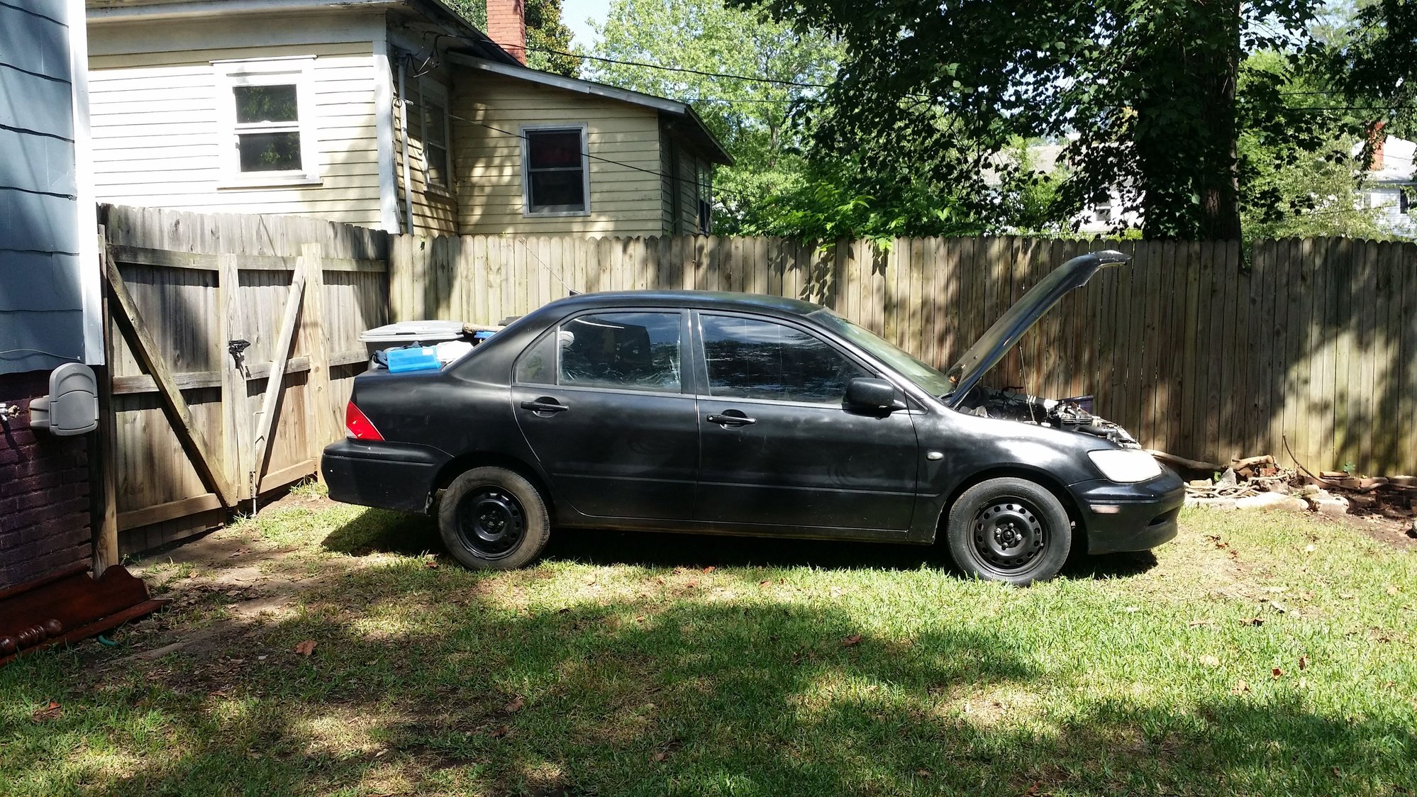

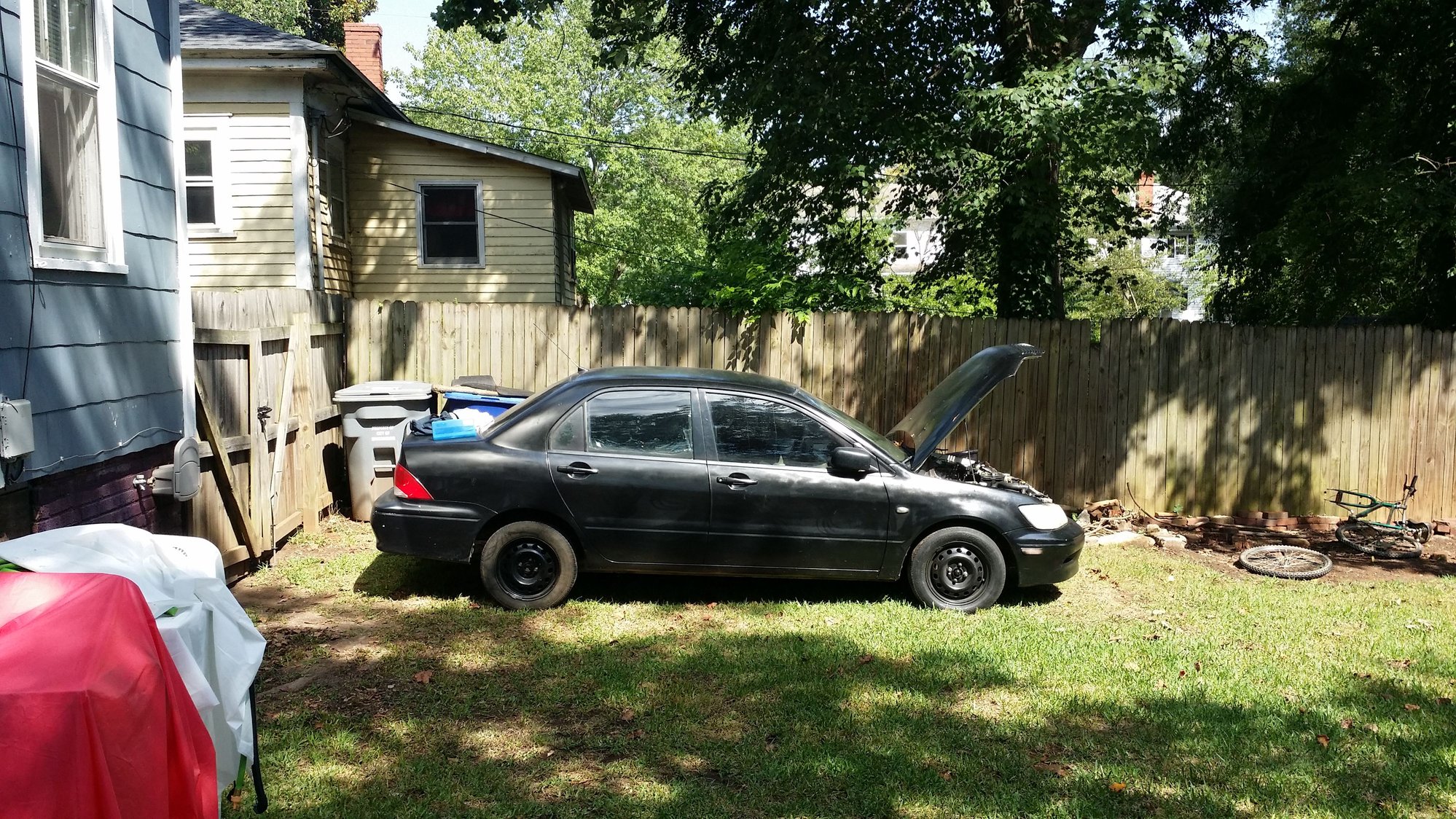

Wow! Thanks so much bro and awesome quality pics might I add! I'll grab that socket hopefully tomorrow, but I wont be able to remove the head until Monday morning early. I removed the valve cover and that big wire harness so far and I have 2 bolts remaining on the intake manifold that need removed, I stopped there a couple days ago because I had other important stuff come up and wanted to get your confirmation about what size of that 12 point start spline hehe thanks so much man. I expect it to be a pretty straight task about changing the head gasket, but I'm sure I will drag it out over a few days if not a week because as you know I'm leaving soon August 26 so basically the Lancer head project I can take my time for now no hurry. I haven't even bought the gasket yet, I just waiting to finish the head pull (my first time ever for any car) so this exciting and a real learning experience. If I can successfully change the head gasket(emphasis on successfully) it would be a real confidence booster for me lol with working on this car the Lancer. But I certainly could not take all the credit no way...because Chris man you have been such a big help. I'm just really looking forward to passing you by on the road one of these days man, that would be awesome .

Justinandcecil's Avatar
Joined: Jun 2016
Posts: 130
From: USA
Just some current status pics

That's not the case. These are the ones that most people are skeptical of, the "universal" sockets. If you look in the pictures, the ends of the splines are rounded. Splined sockets and bits are squared off at the ends. I just finished dealing with my brother's VW. That thing is home to some polydrive bolts, which are like TORX, but worse. They are recessed splined bolts. I picked them up out of curiosity months ago and have tried them in literally every application I could find. They do exactly what they're advertised for. Good catch, though, Crankswick. Until I touched this 1.8T pain in my butt, I hadn't seen a splined bolt before.
