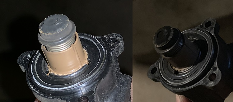

Ok, so I took off the IAVC and the throttle position sensor. Used Carb cleaner on the intake and the IAVC port (got in there with a shop towel to scrub the walls, was pretty black!) Throttle position sensor looked brand new even after 16 years, so I just sprayed it a sec and after drying put it back (those screws were a pain in the *** as there is no room for a normal screwdriver). The IAVC was filthier than Game of Thrones though (see pics https://imgur.com/a/6Rc4pEw). After giving it a good spray or five it was nice and clean.
After reassembling everything... I could immediately tell there was a huge difference. I didnt disconnect the battery during all this, so it retained it's learned settings and holy crap it was overcompensating. When I would get up to like 40Mph and let of off accelerator it was like cruise control, the car wouldnt slow down at all lol, would just keep coasting at 40. After about 10 minutes of doing that it started to decelerate but very slowly (was re-learning). I decided it would be better to juts reset it and let it learn from being zeroed out. So I disconnected the battery and left it off overnight. In the morning connected everything, and boom insta start, like it was the day I bought it. No stalling, no need to re-learn to idle (defaults were fine) and ofcourse deceleration was normal.
So Ive done about 10 starts so far, and each one has been instant like the day I bought the car when it had 0 miles on it. Amazing!
So in summary, replacing pump improved things, cleaning IAVC made the car start like new. Ill report back in a few weeks after I see more starts.
Edit: few more days and about 10 more starts and every time starts like a dream... im quite shocked actually. I have some brand new cars (less than a year old) and it starts just like those now, engine just turns over instantly and wroom its off to the races.
