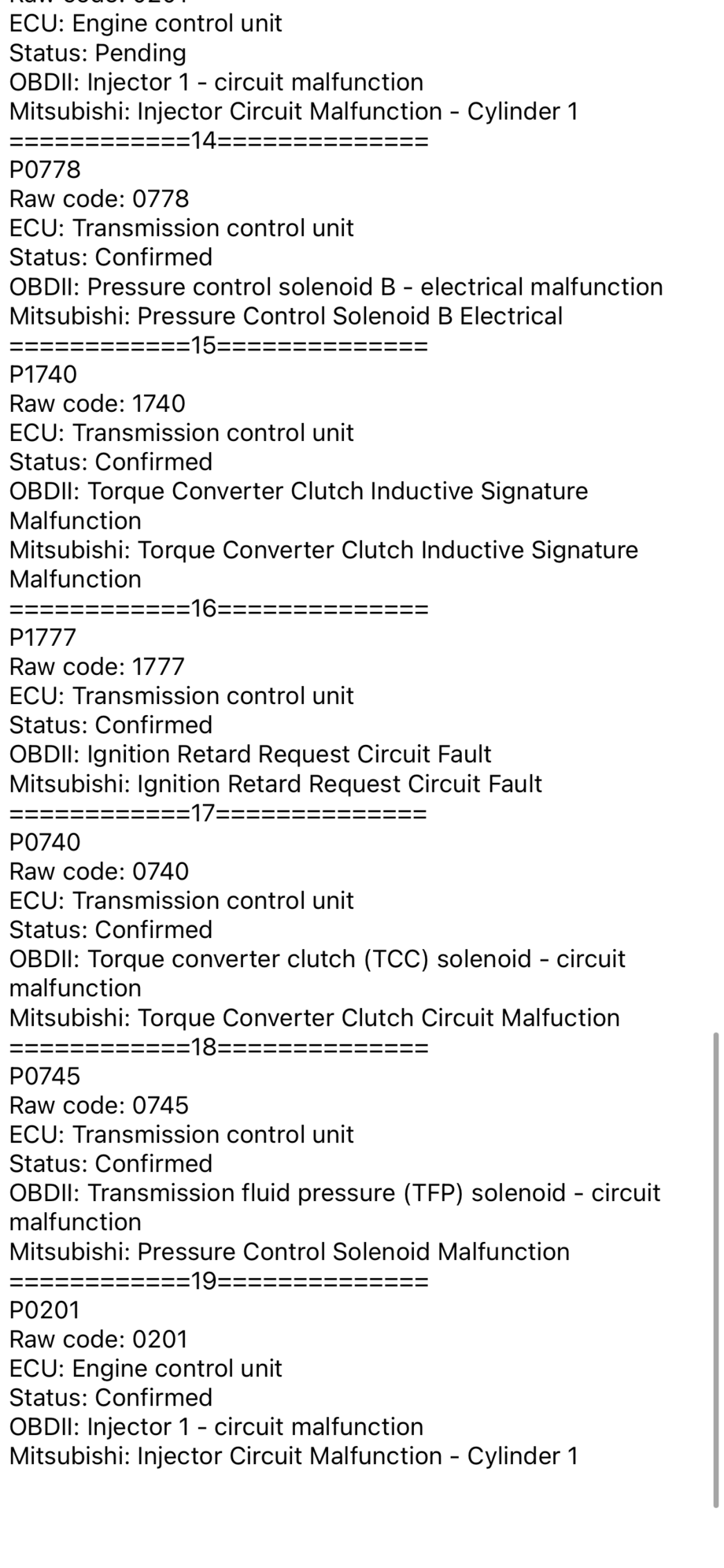

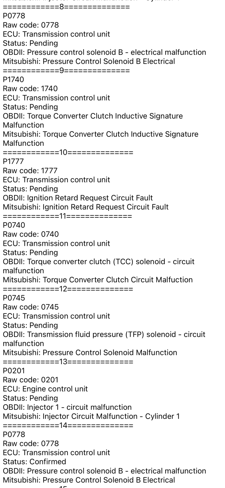

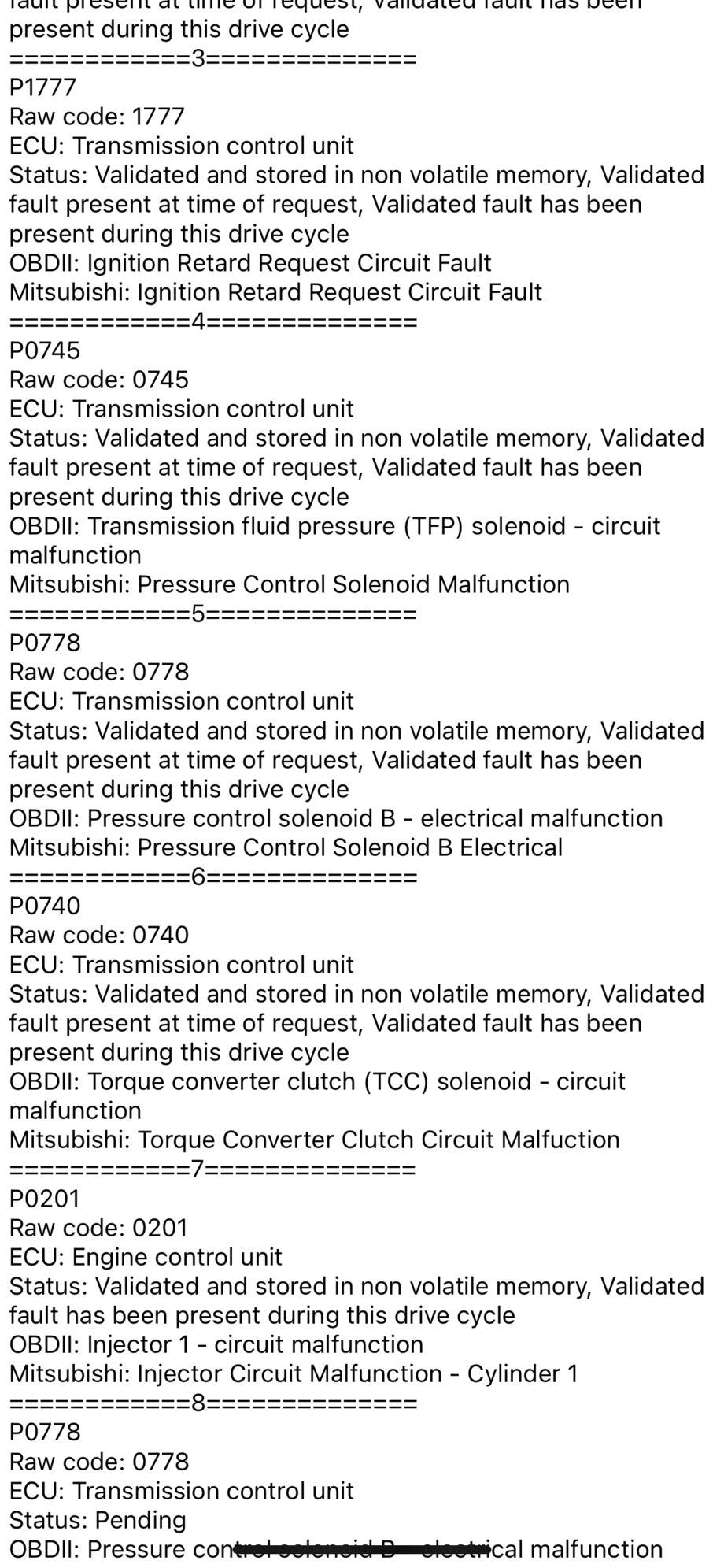

I’ve just rebuilt my engine in my 2008 lancer gts and now it won’t start sometimes. When it does start it sometimes it idles fine for a bit then stall other times it stalls right away. Also when trying to hit the gas when idling it only goes to 2k rpm and wont pass it. Any help will be amazing and I’ll keep on updating info when I remember it
update 1: the injector code is fixed my dumbass didn’t plug it in fully.
