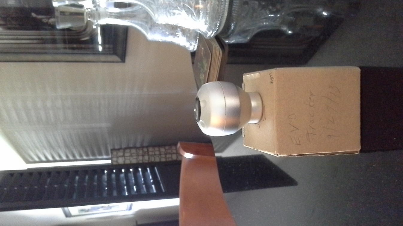

The aluminum ralliart shift knob is nice.

Old Sep 29, 2013 | 07:32 PM
Subi.convert's Avatar
Joined: May 2009
Posts: 288
From: Tx
Where can I buy that!!!
BPAuto (vendor on here) should be able to get it for you. JapanParts.com or RHDJapan.com would be another option.
