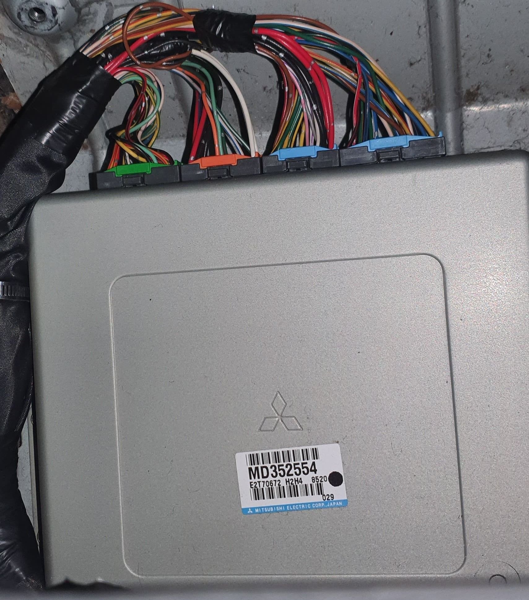

Hi I have a 1998 RVR auto and wish to tweak the tune of the ECU. The ECU has four plugs with an embedded transmission controller.
From my investigations it has two 7202f chips inside which I believe are flash programable one for the engine and one for the trans I suspect?.
I can't seem to find much info on programming this ECU but I believe I can most likely read and write with an Openport 2.0 cable but I will need an xml to suit the ECU.
The ECU looks like it has two extra spots for two extra injectors and possibly is specific to a few models of car maybe an Airtrek or Pajero.
I'm wondering if I cant find an xml or any info would I possibly be able to fit some other ECU like an auto Airtrek 2001 as it is a supported ECU and replace my computer.
is there any resources or info that I can have a read about this car and possible ecu programming or swap that will hopefully not require repining or rewiring the ecu?
The ECU has MD352554 on the sticker on the lid

I see you have the green orange and blue plugs on your ecu. You can probably take any black plastic box ecu from a car with a 4spd auto and plug it in and it should work. I looked at ecu pin outs of many Mitsubishi cars like, Evo, Lancer, Galant, Outlander and the 5spd Auto cars share the same pin outs and 4spd auto cars share the same pin outs. This means you can take a 4spd automatic Lancer ecu and modify the maps and plug it into your harness and it should work. I am using a 2004 Lancer ecu in my outlander. The Lancer ecu was flashed with turbo maps using a tactrix cable.
