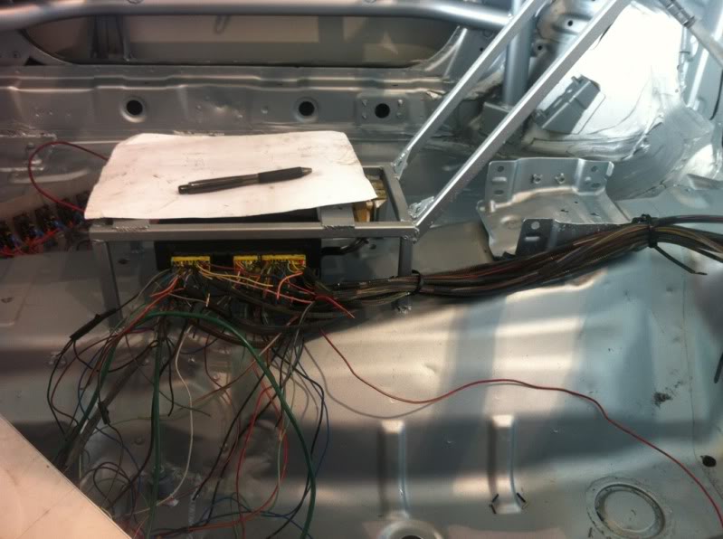

some teaser pictures before i begin assembling the car this week
start of the wiring:
75% through wiring:
