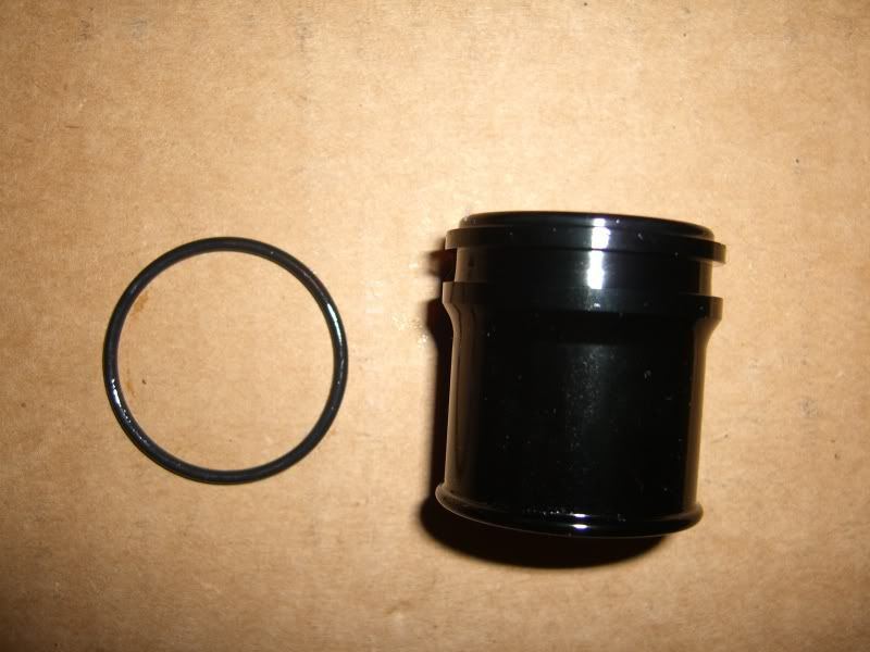

Question for those that have the synapse. I put on on my car a few months back and have been dinking around in the car. I finally had some time to do a boost leak test as Im planning on doing some tuning this week after work. Well, low and behold my BLT revealed that the thing is pissing out air right at the flange. Knowing people had stripped out those bolts I didnt want to crank it down but when I put in the allen key I noticed that is was kinda loose already. So turned it some and sure enough it stripped out.
I tried drilling it out and going up a size which sorta worked however there is still leaking issues as I cant tighten it enough and shockingly while trying to get it to not loose any more air I stripped out the other side. As noted from others the sand cast is very poor and being cast AL its very weak.
But then it got me thinking and this is where I think I may have went wrong. Is there some sort of o ring to seal at the flange as my kit evo specific fitment BNIB didnt come with any o rings. If it does then that is obviously why it was leaking. So now I need to try and get in contact with Synapse which seems like itll be a lost cause. Given that I might be out the $250 I purchased it for but hoping Ill have some stroke of luck.
So if anyone can confirm that there is indeed a o ring, well technically 2 one for each flange then that would be helpful for starters so I know what Im dealing with here. Thanks in advance!
Yes Sir! There is an O-ring on both flanges. Just need to make sure they are in place and properly seated before you tighten that fake and scary "vband" style clamp.
Mine came with two of these:

Good to know, thanks! As mentioned the clamp design sucks. And in my case without o rings its no wonder I wasnt able to get it tight enough to seal without it leaking air. The stock bolts are like an m4x.7 so theyre tiny and going into soft cast aluminum I knew it was going to strip out. Figures I thought about a potential o ring after the fact and was like hmmm I bet it does to which you just confirmed...
Now the trick will be getting a replacement and/or refunded.

Fingers crossed that Im able to get a resolution here and at the very least get a replacement body. Also, does the o ring go in between the two flanges or is there a groove that it sits in?
