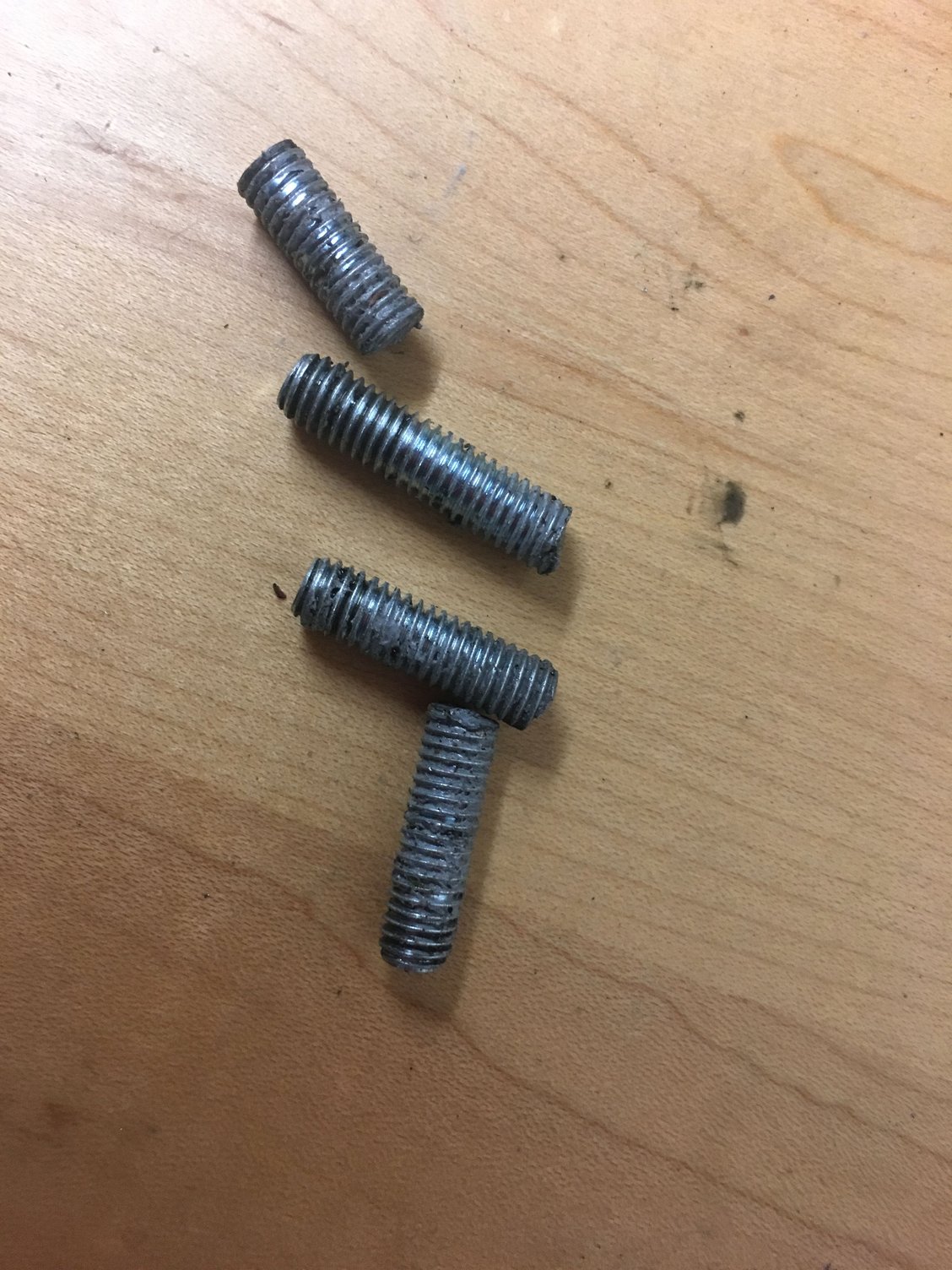

Neat trick for lining up the pan when working alone. Cut the heads off some extra bolts and use them as dowel pins to hold the pan in position one handed while you put in the numerous pan bolts. Makes it less likely to smear the RTV too much. Just don’t tighten them or they will be a major pain to remove. A lift and a helper would have made this job easier, but this trick helped me a lot. Learned it from a YouTube video. Maybe it’s common knowledge to everyone but me <shrug>

I've got these plastic bits that thread in. They have "barbs" for holding gaskets on while you line up/put a pan on. I use them for my Evo, too. Lining things up = priceless.
hex key set screws work better in the correct size and you can remove them with the hex key= no worries

I use plastic dowels that I got off Amazon. They are meant to hold gaskets in place while raising the pan. I happened to have them laying around and they work great. Of course, you gotta have them before you start, so not that great of an option when you're sitting there with HondaBond on the pan....
