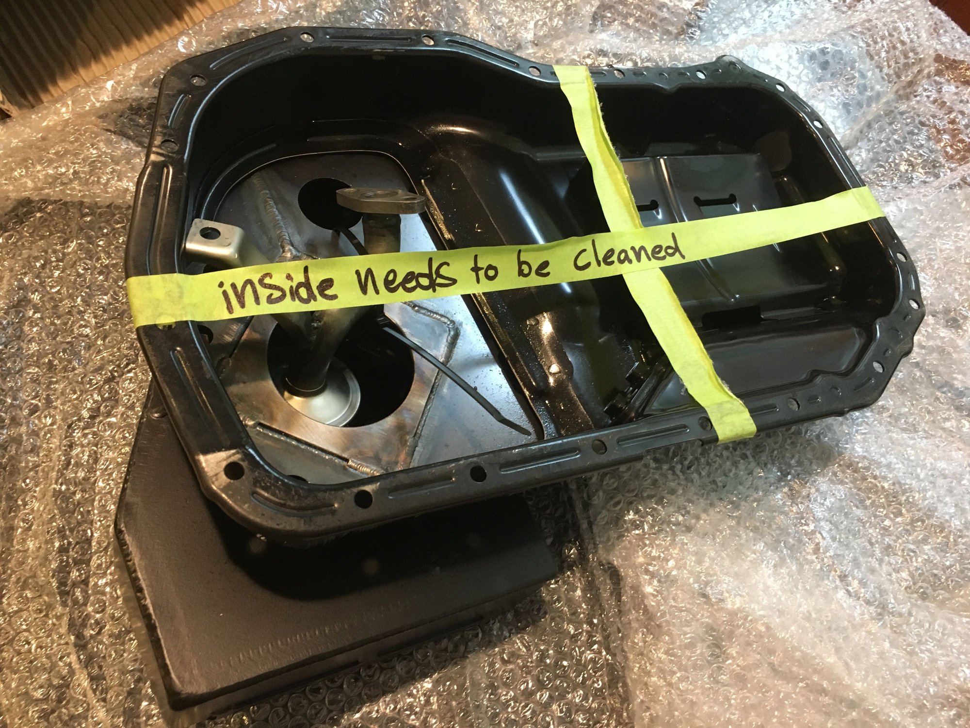

It’s here!

So, obviously it needs to be cleaned before install. Do I need to take it to a shop with a parts washer, or do you think it just needs to be flushed with brake cleaner?
I had not planned on the scraper. I am a little concerned about the install of that, in particular making the judgment whether it is running too close to the crank. My crank is stock, but my bottom end has been redone by Buschur years ago and the motor has been perfect. So, I'm a little unsure whether I want to touch anything beyond the pan.

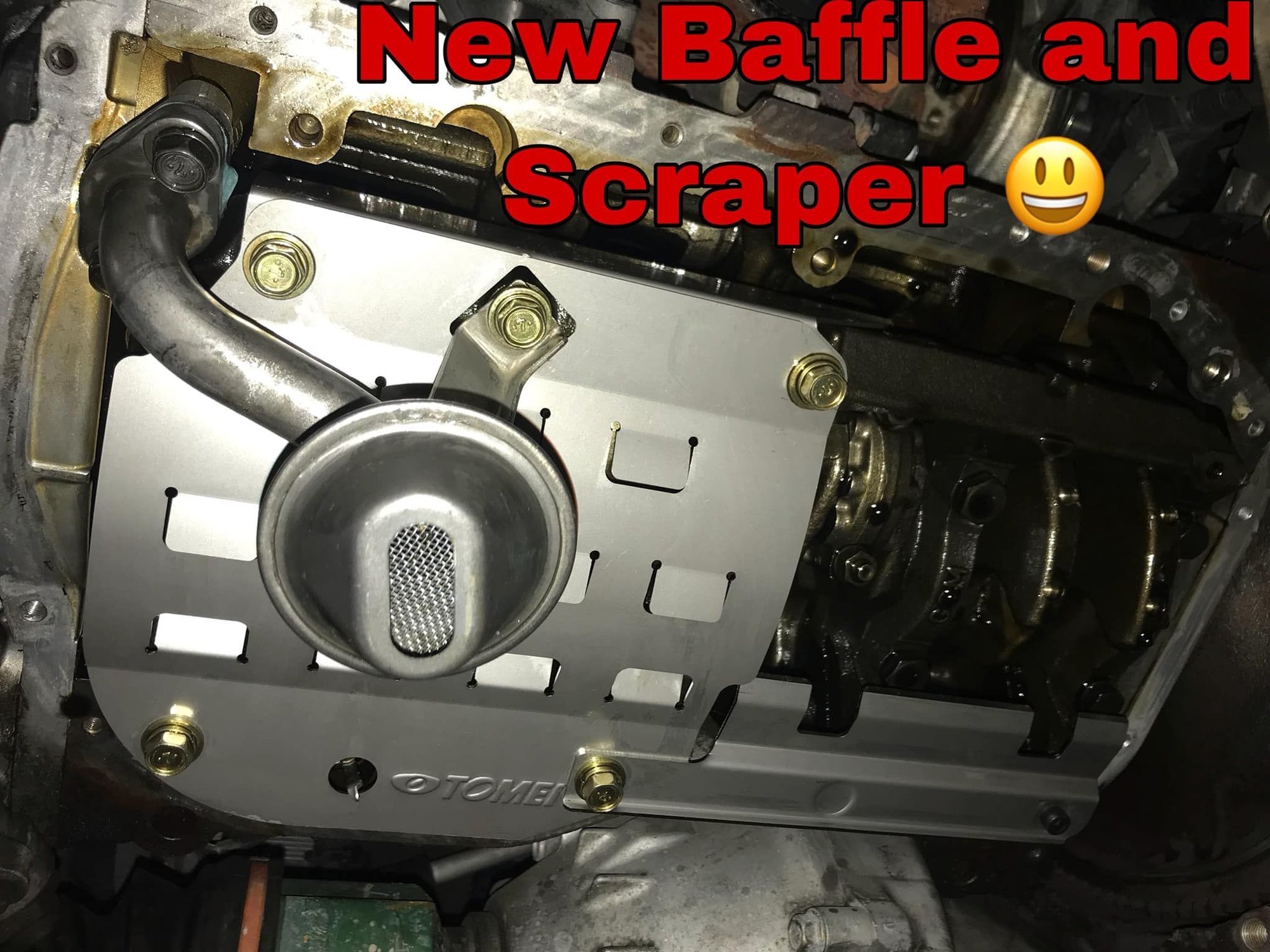

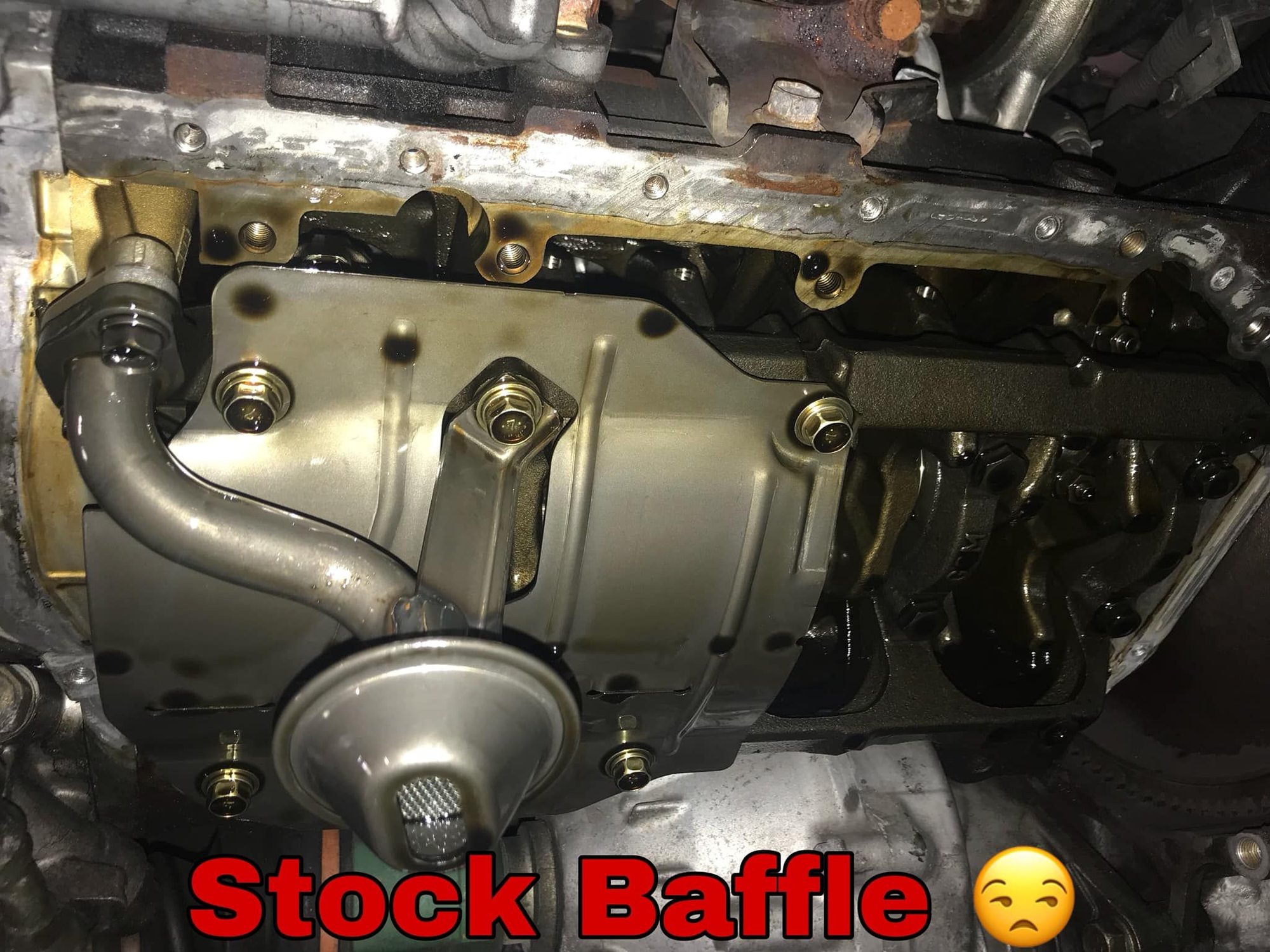

Old Jul 22, 2019 | 03:22 PM

I found those photos above on Facebook. It doesn't actually look too bad to install that setup. Should I expect to need to bend or grind anything to have sufficient clearance? I found some instructions on line for the Cosworth suggesting that you need to have .060" clearance from the counterweights, so I guess you rotate the motor with the plugs out and check that with a feeler gauge?
Old Jul 22, 2019 | 03:32 PM
  #551
LetsGetThisDone's Avatar
Joined: Oct 2013
Posts: 15,973
Likes: 1,629
I didn't have to bend anything with an Eagle 94mm crank and Carrillo Pro-H rods. An 88mm crank should have PLENTY of clearance.
Is 88 mm the thickness of the counterweight? .060" is like 1.5mm, so you are saying you didn't need to clearance it using counterweights that were 6mm wider than stock?

If it fits super loose like letsgetitdone is saying, then I'm not sure what could be done to clearance it? Bend it closer to the counterweights?
I'm referring to the stroke of the crank. And the eagle does have wider counterweights, but I'm not sure how much wider.
