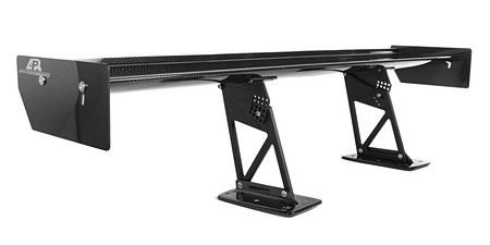

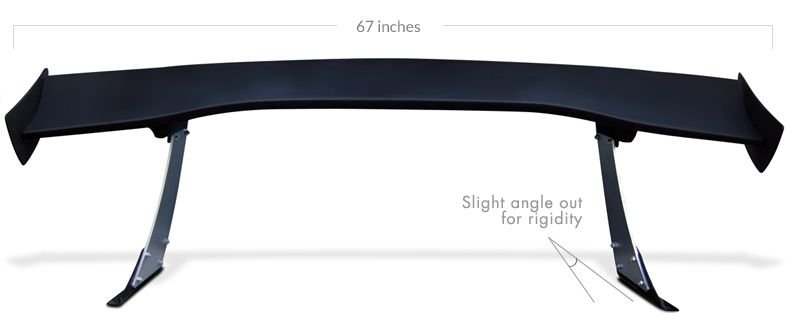

couldn't think of a better place to put this. Im currently re-doing the aero on my time attack Evo 8. and im looking into different wings. and i came across big country labs. I was wondering if any of you have this wing and if so is it just a show and drift thing? also if anyone has a APR GT 1000 wing please tell me how its doing for you. that was another one i was looking into. thanks!

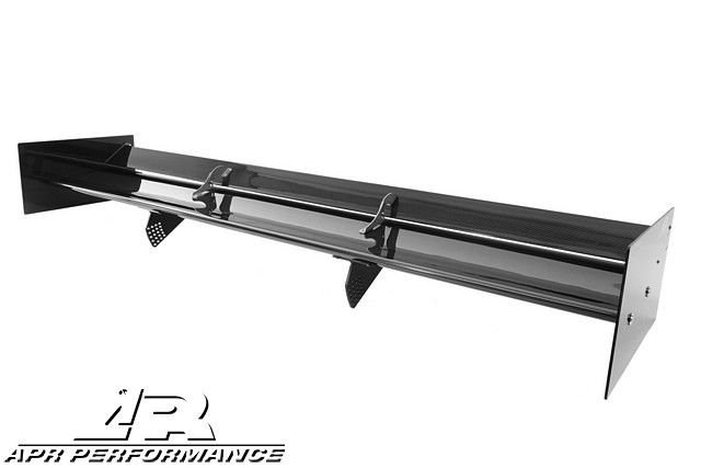

the APR 1000 is the biggest baddest wing one the market right now for making down force. unless you have some crazy front aero, you're probably better off running an APR 250

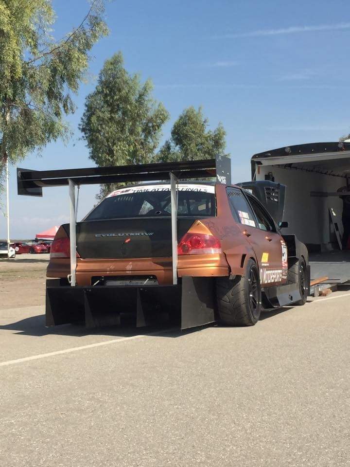

Ditto it is what I'm using and I have splitter, canards, and underbody. I still don't take it beyond 10 degrees aoa

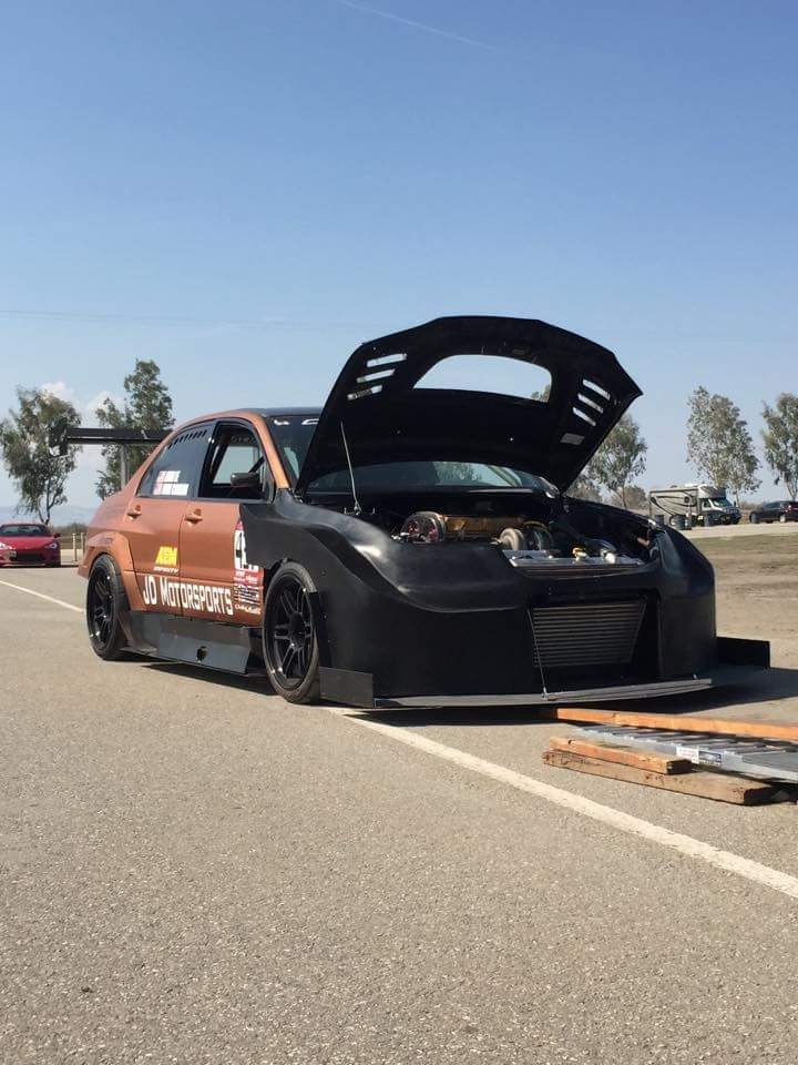

We run the GT-1000 and it is a beast. But we have a lot of aero to compensate for how much rear downforce we get from it
