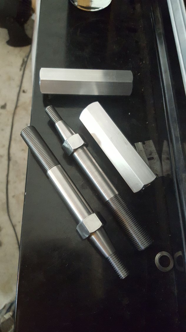

To bring this back up, I now have a bunch of couplers with M14x1.5 on one side and 5/8x18 on the other for my uprights. One thing to note, the steering rod is long enough that any rod end will interfere with it on stock control arms so I am cutting the rod ends down and fully threading on the couple to the rod end with a jam nut. I have to cut about 1/2" off the rod ends to make sure there is enough adjustment before steering rod and rod end bump uglies.
Probably less of an issue with folks running less camber or longer control arms. Will try and post pics tonight.

Just checked on the extra space I can get with my current coupler. Its 50mm long and fully seated as shown (rod end bottomed out in coupler) gives an extra 5mm spacer theres plenty of thread to increase that another 10mm so 15mm of spacer.
In my case, I will be cutting the rod end down 1/2 since there doesnt exist any with a short enough shaft for high camber and stock control arms.
