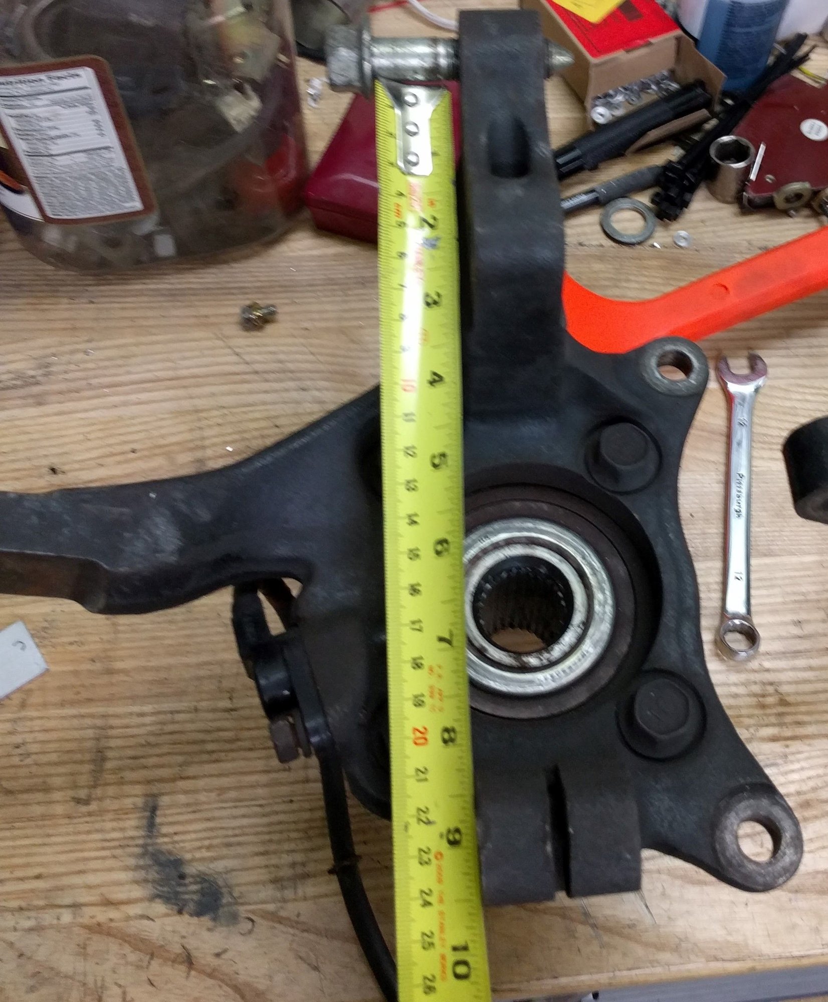

I picked up a set of Evo 10 hubs after getting some helpful advice. I did some test fitting today and they do indeed look like a direct bolt on.
You can even see the lower joint is rasied.
Evo 8/9
Evo 10
I did run into an issue and was wondering if anyone has been able to overcome this?
I want to keep my ABS and ACD; however, the Evo 8/9 looks to has a passive sensor with a metal ring that fitted to the axle and the Evo 10 has an active sensor with a magnetic encoder that's built into the wheel bearing. I thought about using the Evo 10s wheel bearing, ABS sensor, and wiring it in. However, the EVO 10's splines are bigger and I'm not sure if my Evo 8/9 ABS ECU can read the Evo 10's sensor. If I swap out the wheel bearings, I will not have the magnetic encoder that's built into the wheel bearing.
Thanks for the help in advance.
Here are some pictures of the hubs

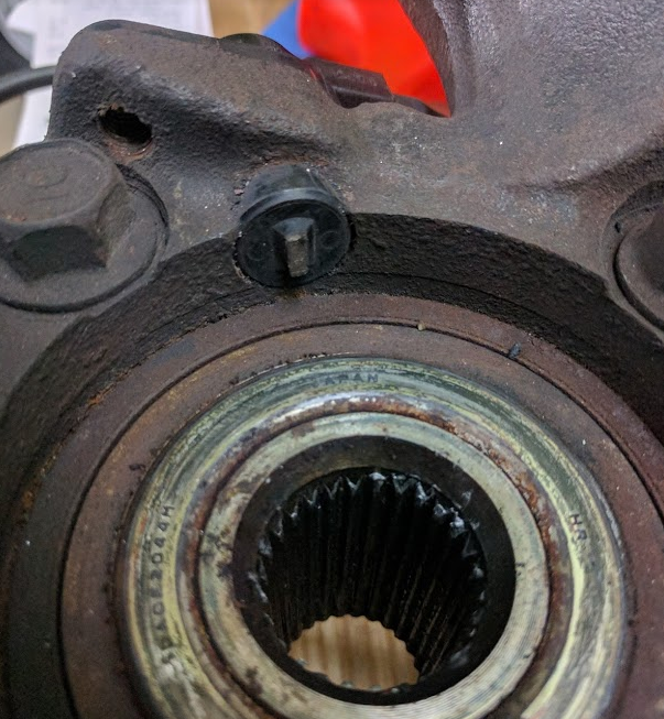

Evo 8/9 ABS sensor. it's a fat boy

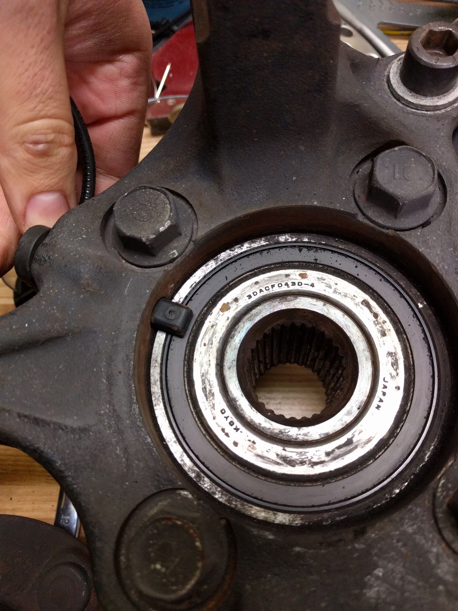

Evo 10 ABS sensor with the magnetic encoder ring

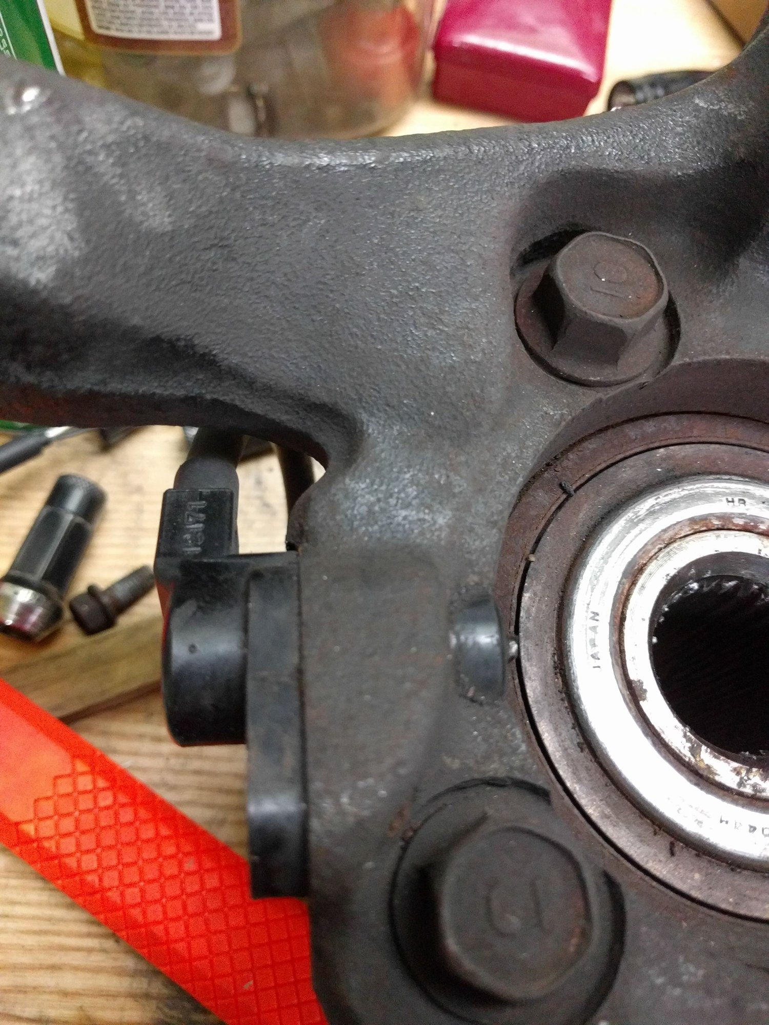

I'm sure anything is possible. However, it might be costly and near impossible. Due to the sensor being clocked differently, 8/9 has a much bigger an shorter sensor, and its located in a different position.
Originally Posted by Dallas J
Hmm, well this does answer a few things for me and my billet uprights. They certainly look like it would be no problem to fit but I don't think I have an abs solution. Can you tell me if they are in the same position but just need a different clock position for the screw?
The sensor is clocked differently, 8/9 has a much bigger an shorter sensor, and its located in a different position.
Evo 8/9 sensor. This has become one

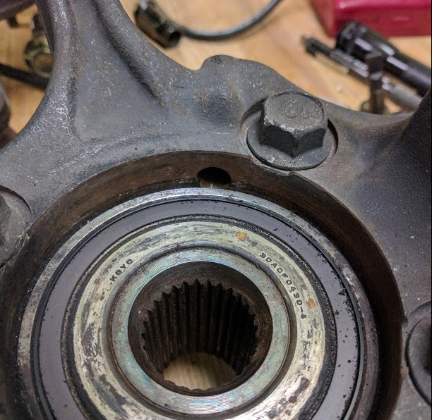

Evo 10 sensor hole.

Long and short of it, the Evo X hub and arm allows for better roll center geometry for the Evo 8/9. The ABS sensors allow for a functioning ACD system and I prefer ABS as it helps prevent flat spots.

I'm not sure yet? However, I'm not worried about bump steer because I can correct it with my tie rods and spacers.
If I can't figure out a way to to keep the ABS, I may not run it.

I plan on doing this myself, along with evo x LCA. I don't see an easy way to keep the ABS without plugging the stock evo x hole, welding a piece of steel in the location of the stock 8/9 sensor, and drill it for the 8/9 sensor. I think anything else will be a big pain and a lot of finger-crossing to hope the different sensor / rings and ABS system can talk to each other.
But I am keenly following your thread for easier solutions.

Part of my concern with this idea is making the knuckle weak because you will need to remove material. The 8/9 sensor is fat and short.
I hope someone has an easy solution.
