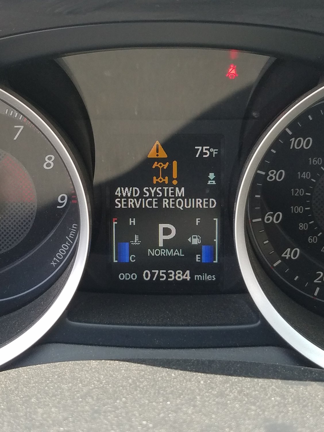

Last weekend we had another NER autoX and it started pretty good with my first run being in the lead. This is kind of rare, but Rachel wasn't there, so things got a bit easier for me!
After the run, I went out and sprayed everything and when I went back in to check my run on SoloStorm, error popped up on the dashboard:
Restarted the car and same thing was still there!
Since I got my latest ACD pump installed few weeks before that was a first suspect, but I still had no clue there. Was it coming from the trainy instead. 75k miles and I did launched this car few times here and there? Clutches being warned out and started to slips and overheated the trainy?? No clue!

Oh, one more thing! Went to dealer today and they told me that error was for stuck AWD mode change button...go figure!
