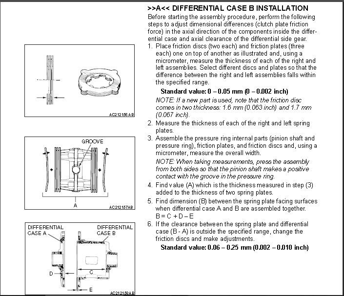

Turns out I was stupid and threw away my OEM clutchpack (It DID have 130k miles on it). Where can I get a replacement? I can't seem to find just the plates, anywhere.
**edit: here are the measurements from the FSM. I did not do this with the Weir plates. I didn't think it were necessary, since there is no way to make adjustments. Also, I see the OEM plates with different part numbers for different thicknesses. I have no way of knowing which I need.. so guess I'd need to buy an extra 4-8 plates just in case? That sucks. Or buy a set, measure, do the math, order accordingly. That's a lot of down time.
The site is not letting me attach to my edited post, so I'll add below:

Old Jun 4, 2018 | 03:27 PM
