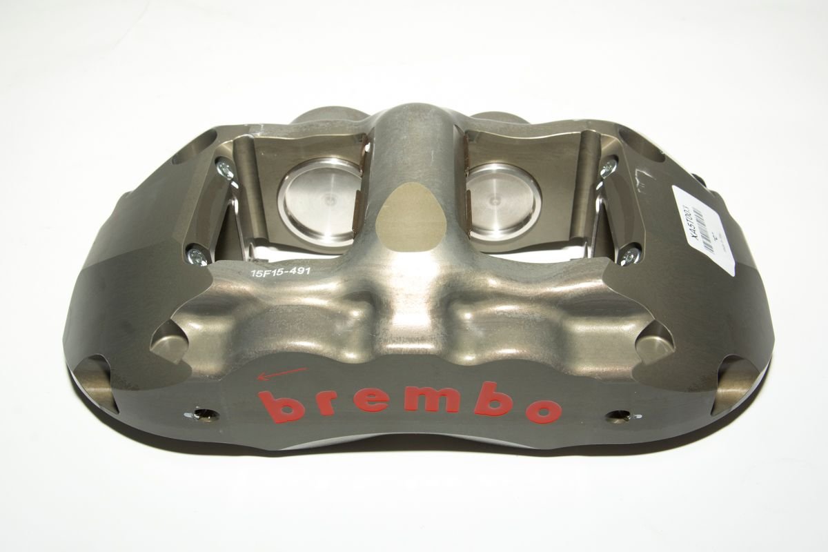

actually it depends on the racing application.
The brembo racing rally kit (GrN) is another 4 piston caliper that is monobloc and has an integrated bridge, so it is caliper off for pad change. The upshot is a stiffer and lighter caliper that is also lower profile, so manages to fit 355 mm discs into 17 inch wheels.. if nedeed..
