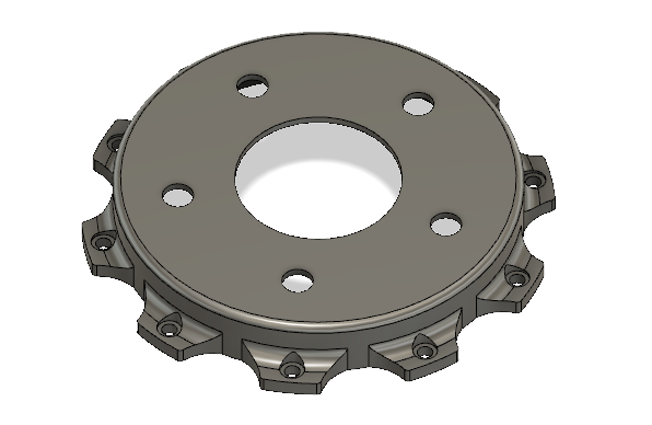

Oh and last night I hashed out the center hat design, still need to get a rotor to finalize some numbers and print off a prototype.
