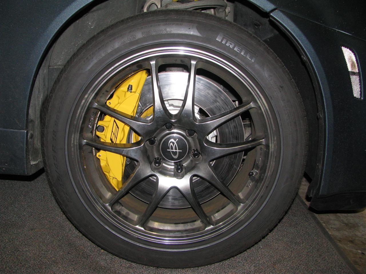

I cannot find a single thing online of people having legitimate problems with the factory C6 Z06 calipers. Once again, this isn't supposed to be a be all end all braking solution, merely an affordable step in the right direction for guys who can't or don't want to fork out $3k+ for a set of brakes.
I don't see such a setup being a step backwards in any measure from stock except for consumable cost which should be on par with anyone who's already running 2 piece rotors.
I appreciate your input and if you have anything else to share I'd love to hear it. Please don't think I'm being dismissive of what you're saying, I just can't find anything that supports what you're saying.
Old Oct 13, 2018 | 10:37 PM
Ayoustin's Avatar
Joined: Jul 2014
Posts: 2,989
Likes: 648
From: SC
For anyone curious, here's what a 380mm disc w/the caddy caliper looks like under an 18" wheel:
