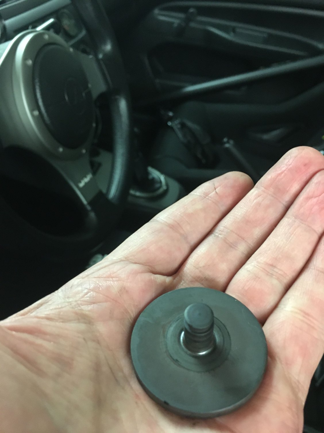

Ugh. This just fell into my downpipe when I was trying to adjust my wastegate arm tension. Obviously, it was already broken. No wonder my BBK Full has been spooling like an FP Black. Is this at all common? Not sure if my turbine housing will be repairable. Going to pull it apart this weekend.
FP has the hotsides still, but you have to call. I think I paid around 300 for one.

I’m not sure if Blouch modifies the turbine housings for the BBK/1.0xt turbo, but when I started tearing into it, I found some oil in the intake tube and shaft play, so it might be time to get a new turbo anyway. I haven’t done any track events this year, so I think I can direct some of those savings to new upgrades and make lemonade from lemons 🙂
EDIT: I compared it to my near zero mile Evo8 stock turbo and I actually don’t think the up/down shaft play is more than my stocker (no thrust play at all), so hopefully salvageable. Going to check with Blouch.

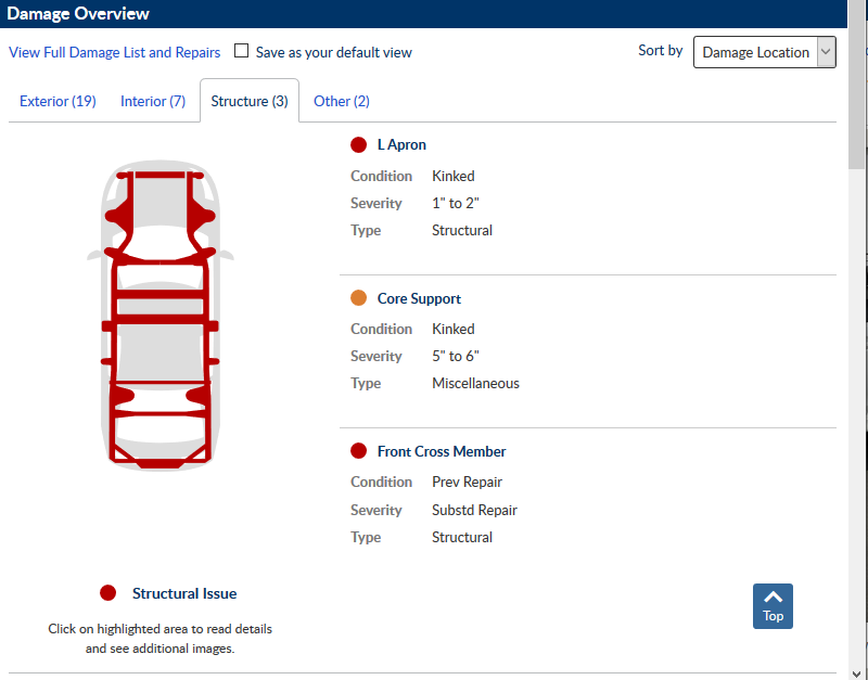

Came across a white Final Edition at auction today, rebuilt title from a total loss claim in FL. Looks like a front left impact as they did a sh*t job of bending the core supports and subframe back together. They're asking 8500k, but as a parts car option wonder if I could get it down to 2k lol. Watcha'll think

Parts car for what? You could sell the seats...wait nvm

Tons of little issues, air back light is on, etc. Found out his ceiling is 13.9k...pass lol. Unless one of you wants a project car.
