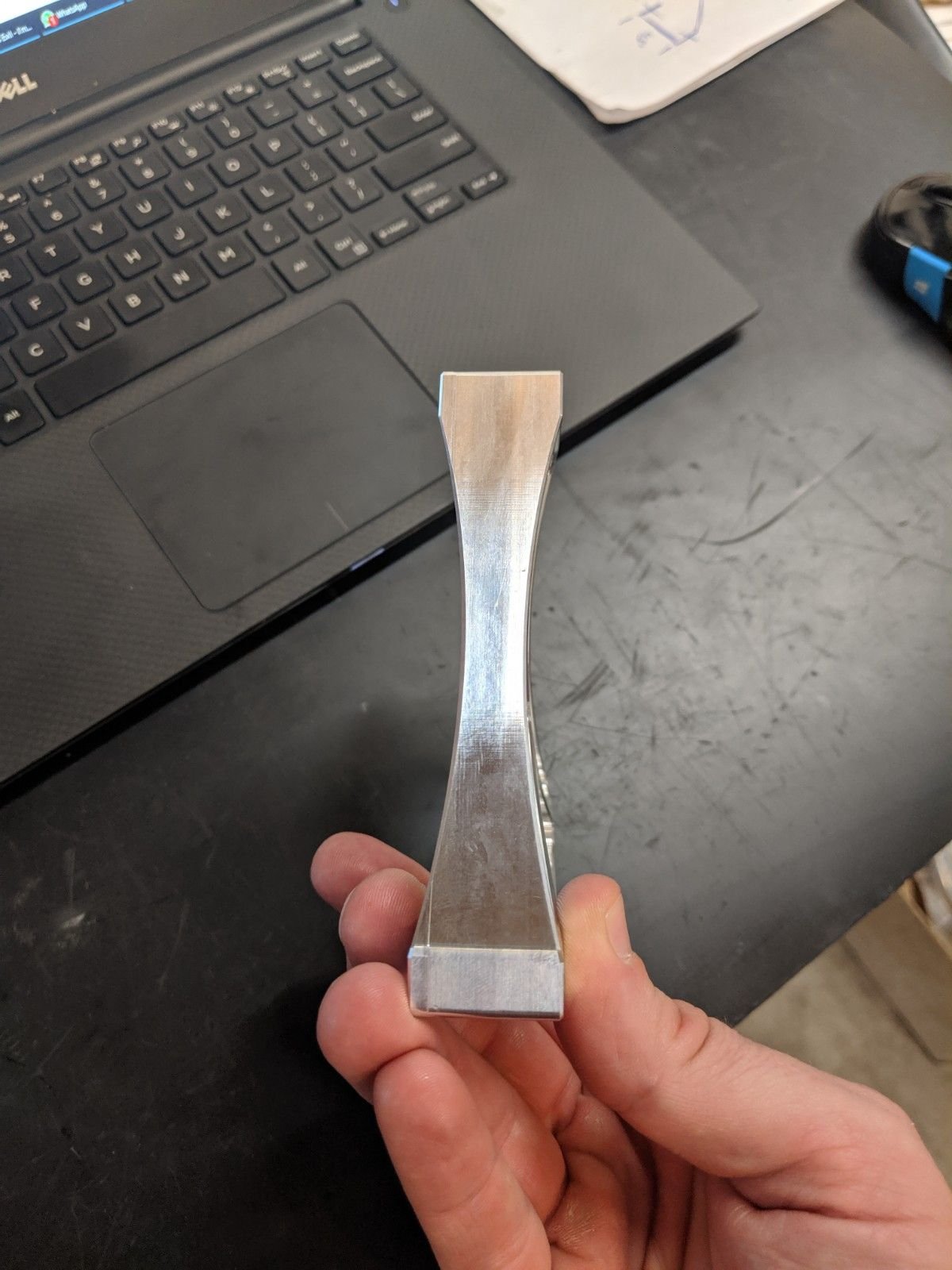

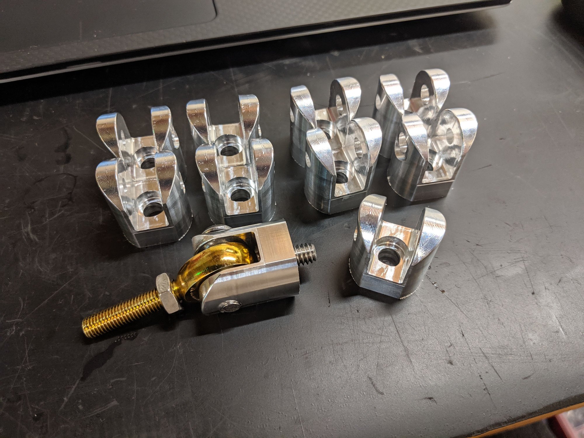

Finally getting around to making my splitter (Ignore the mess, Im into way to many projects half way done but a big cleanup is coming next week) . I of course cant just do things standard so I decided to make my own things original to me. I didn't run more than a quick FEA on the drop mount for the middle, but that should buckle if I hit anything too hard instead of ripping things apart.
Height is 3-3.25" with very slight adjustment pushing nose down. There are 3 rods along the front and two back by the tires. Length is 5.5" to be safe from 6" limit and I sort of just copied the geometry of the lip on my car to give it at least some interesting shape. The corner I also sloped inward to help avoid cones on the outside of the car in certain areas and the width overall matches the width of the tires. The plan is to have the flares come all the down to the splitter to fully block the tire. Also working on blocking off side openings in the bumper since I have my ACD and Oil cooler relocated.

315 ftw. I also love the machined clips for the splitter and then there's the home depot racing department clips for the oil cooler
She plywood?

Heh, they are actually aluminum strips I cut and drilled for the oil cooler. It just ended up a little off from my first measurements so the edges I ground down didnt end up horizontal/vertical. One day I'll redo them to be equally over the top
Splitter is 3/8" plywood with the intend that Id use this as a template to then make something nicer but looking at material weights and durability, Im finding it hard to justify anything different.
