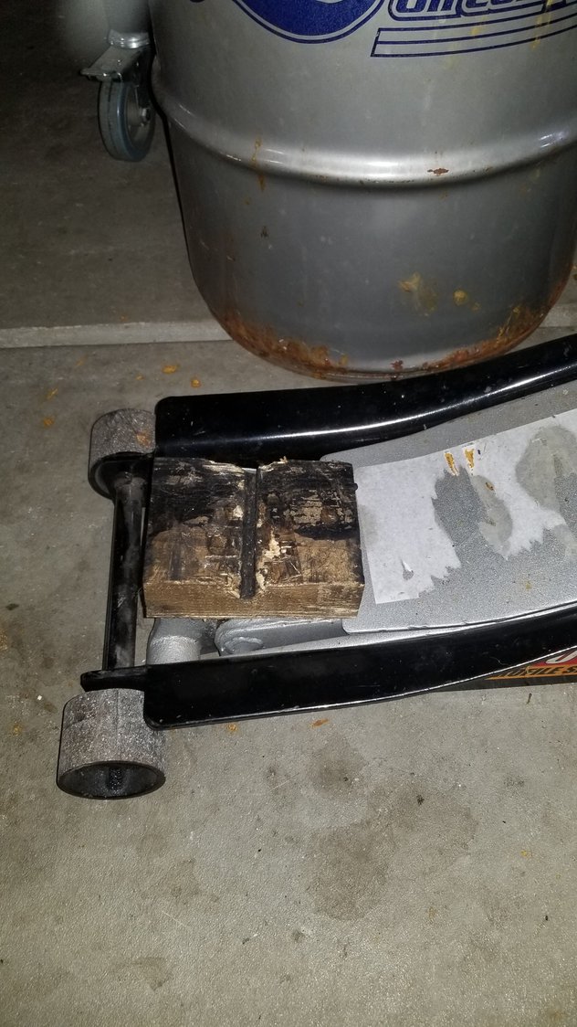

Side pinch welds and under rear diff. I cut a slot in a small piece of 2x4 that the pinch fits in. Works perfectly.

They have specific pinch weld adapters to floor jacks but I always hated jacking up from the side. Im spoiled with a lift now but reminds me bc I have an AMS north south bar now and not so sure I can use that as a front jack point so should grab a pinch weld adapter and add into the toolbox on my trialer with my jack for the trackside fixes.

This is my "adapter" haha. Going strong for years

I use hockey pucks
