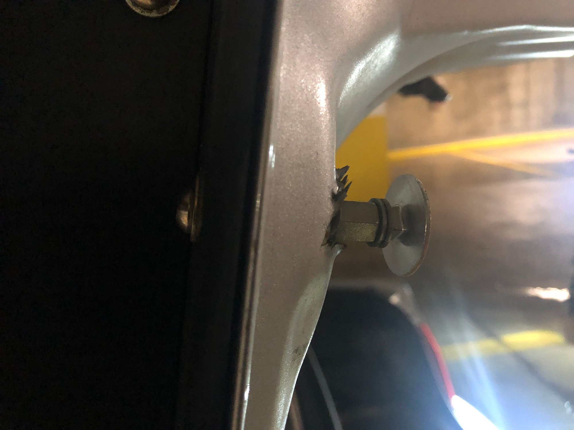

If your wing only attaches to the stock wing area mount points that's definitely not enough. Here's my Kognition trunk plates. The use the stock holes and add one more towards the middle.
Also my trunk is solidly mounted using threaded spacers and elevator bolts. The bolts that go through the base plate have threaded female spacers on the inside and elevator bolts threaded into the other end which give a larger contact patch to transfer the force into the chassis. My trunk doesn't sag or bend at all if people sit on it, once the elevator bolts are set to the right length the only way the trunk latches is if you slam it pretty good.
