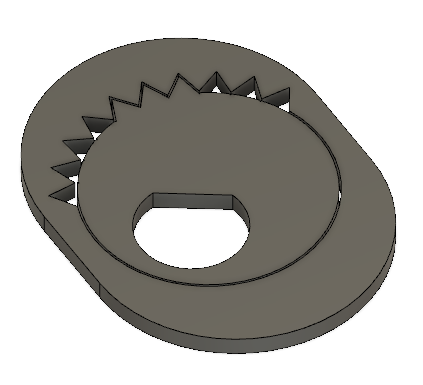

Would anyone be willing to make something like this for our cars? Being able to accurately swap alignment between track and street settings would be a cool bonus.
https://pacomotorsports.com/product/eccentric-locks/

I can certainly draw that up pretty easily but I'm not sure the recession that it has to sit in on the chassis is big enough to get a good range of adjustment. Might be able to make it work tho.
I'm thinking the teeth could be relatively smallish. Since the "washer" will fill the entire adjustment area, it won't have load trying to move it back and forth like it does now. Turn bolt to desired setting, slip washer over to lock it in place, and done..
Is it really that simple?
They would work for camber and toe. Easy peasy?
I'm willing to pay to make prototype. I also have access to a machine shop with a 5-axis, if that helps.

5 axis is overkill. This can be done easy peasy with a water jet or a laser table. I still need to get measurements on some of it but lucky you, I can't sleep tonight:

Well either way, it's physically impossible to make this with a 5 axis since a mill can't cut inside corners without a radius. If you're serious about wanting to get this made I'll actually get the dimensions correct and everything.
Could make with a 4th axis or lathe with live tooling and a custom slitting saw. But thats nit-picking. These are something would probably be cut with a die in a big sheet metal tool. But you'd need to stamp out a lot to make it worthwhile.
Better option, learn to align yourself or find a monkey that wont wreck your stuff.
Hence why I said waterjet. Wouldn't be very pricey at all to cut these out and all they need is a couple .dxf files.
