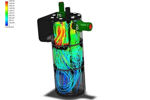

First off, love STM for lots of reasons, but they fell short here. So for those of you that have the STM "sealed" catch can, I did the unthinkable and cut it open because if was curious how they set it up. Turns out they didn't really do much....
No real filtering of ANY kind going on. Simply this 1/2" gap? between the two side walls where the oil comes in and the air gets sucked out. I was always curious why I was getting so much oil (6an vs 10an) and why was oil in the pan so "water'y" so then I started to dig further. I'll now be running a Radium can which obviously has a better design as a previous post described but I couldn't find it. So far around the same price, you can see OBVIOUS differences, you decide.
