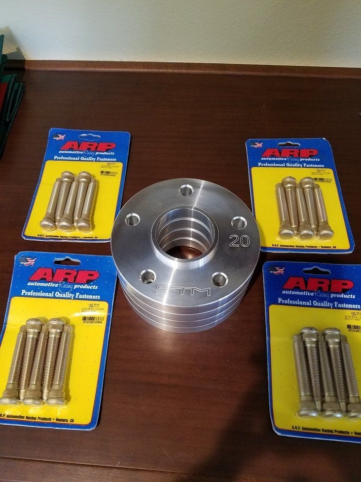

The STM 20mm wheel spacers on OEM BBS are a hubcentric match. Once the wheel is on the hub and flat before installing lug nuts, there is no play around the studs or up, down, side to side. I've driven with this setup for thousands of miles with no excess vibration on various power levels.
Spacers do change the fulcrum angle between the wheel bearing and the center of the wheel barrel against the ground, creating more angular load on the bearing races. As it turns out getting a wheel with a different offset is not the same thing as spacers because when a wheel is designed, regardless of the offset, it's build it so that when it's installed on the car, the load from the vehicle is scene across the center of the tire. If you add a spacer without changing the design of the wheel (adding material to the back where it bolts to the car or changing what depth the wheel spokes connect to the wheel barrel), it moves the load away from the virtual center line of the tire and puts it more on the inside. Chamber is not the only thing that decides where your tire wears.

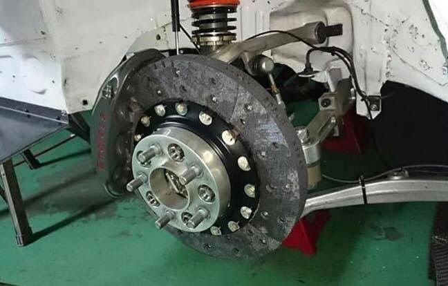

The Fire Ando/Escort evo (one of the fastest TA evos on the planet) uses bolt on wheel spacers. I show this photo to anyone who trys to rant to me about how destructive and unsafe spacers are lol
Originally Posted by heel2toe
In my mind its the same exact thing, no?
It is
