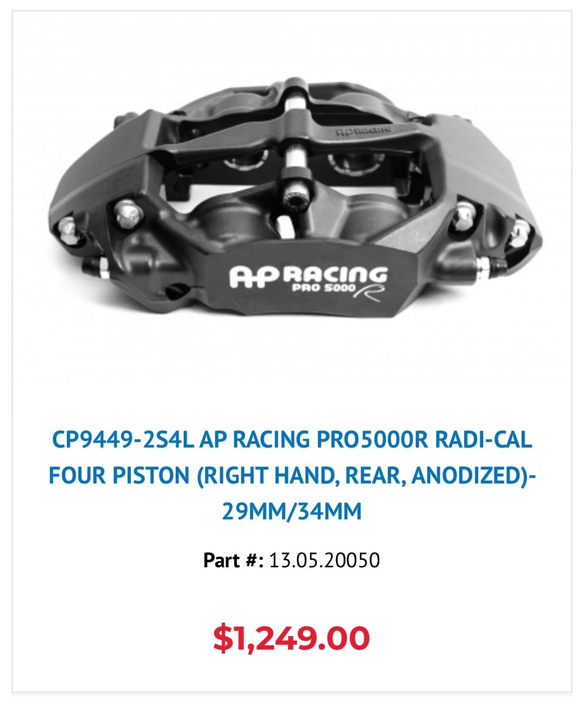

Do you know what caliper the AP kit was using? If there's enough interest I could get a run of brackets made to use those calipers with stock discs.

AP doesn’t have too many options for calipers - i imagine the basic 4 piston would work.
to keep the bias somewhat decent I imagine we’d want to run a 6 piston up front. If you’re running a 6 piston it’d be hard to not get the radi-cal series which doubles the price. For the front that’s justifiable - for the rear I’m not sure.
