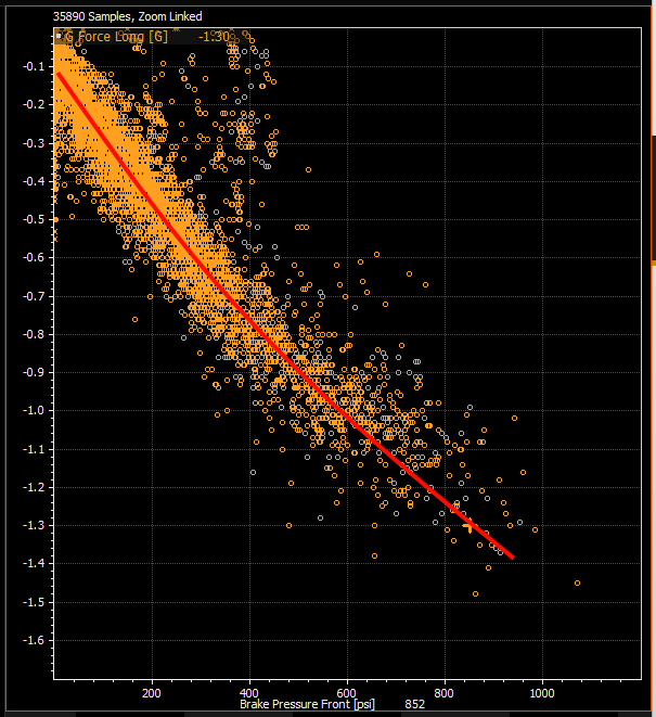

Going from the Brembo 4POT calipers to the ENDLESS 6POT firmed it up a lot. And I'm using ENDLESS RF650 brake fluid which is one of the best (if not the best) on the market.
Here is a scatter graph from my last track day.
X - brake pressure in PSI
Y - Long G-force
The tyre maxes out at around 1.2-1.3 G during stops, so I only need around 700-850psi to reach that.
With the factory brake booster it's extremely easy to generate 1200psi ++, so I would this much easier to control.

Originally Posted by Balrok
I'm not sure where my old plots are, they're in that brake post we did awhile back, but with JUST 8350's up front and DS3.12 pads, and DS1.11's in the OEM rear, I was getting 1.6g's consistently under hard braking.
What tyre and size? Any aero?
1.6G is 997/991 Porsche Cup Car level of braking. Are you sure your data was correct?
GT3 cars with 300/310mm slicks are around 1.8-2.0G under brakes. High aero.
Yep plots just like yours with RaceTech I believe was the system then. The Nasa rules at the time was 275/35/18 hoosier R6's. The videos from then show it too. Circa ~2007ish we noted that welding or bolting a support on the MC in the engine bay plus RF650 significantly stiffened the pedal feel. Now with Ap 9660's and A7's we brought that number up to 1.7. HOWEVER, as explained the 9660's do not create more "torque" but they simply allow more heat without the requirement of brake ducting during 45 min sprint races. Ducting on our cars is nothing more then a pain in the a**.
If I got too aggressive with the gas to brake transition you'd get that stupid ice mode so there's timing to it. I have to pull on the porsche's and brake later, harder. That millisecond when they brake at 300 and I at 250ish allows the boost to dissipate while we get on the gas sooner then them. FAE is a 3170lb with a fat driver race car so YMMV. The kit in question is no slouch, I raced on it for years before upgrading again, and sold them as nothing was worn or broken in all that time.
@RSMike thanks for sharing data.
What datalogging hardware/software is that chart from?
Emtron KV8 with Motec C125 dash.
The software from the picture is Motec i2.
I choose which parameters to push from the ECU to the dash for logging (via CAN). I only log the Motec, not the Emtron as well (ease of admin)
