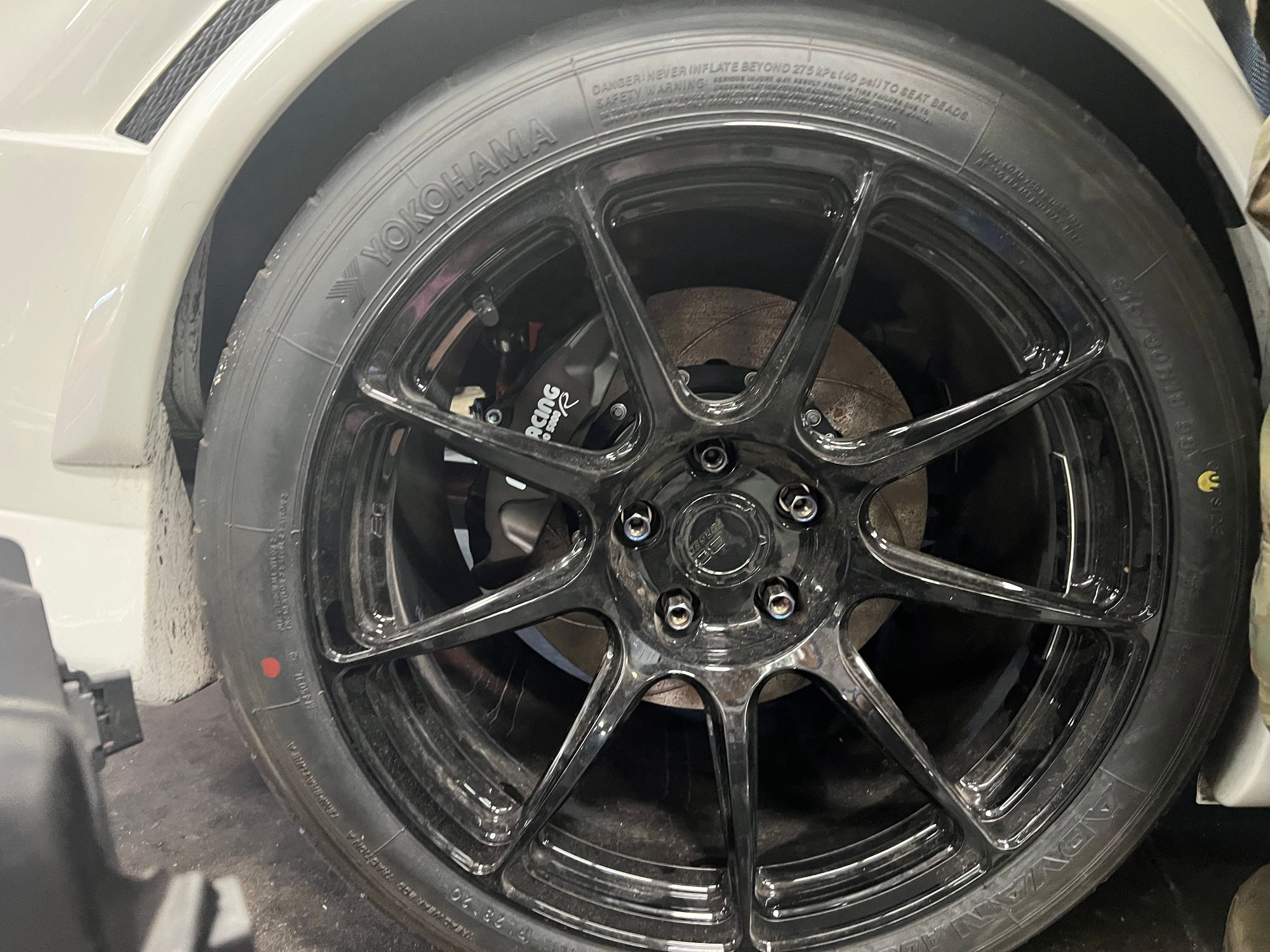

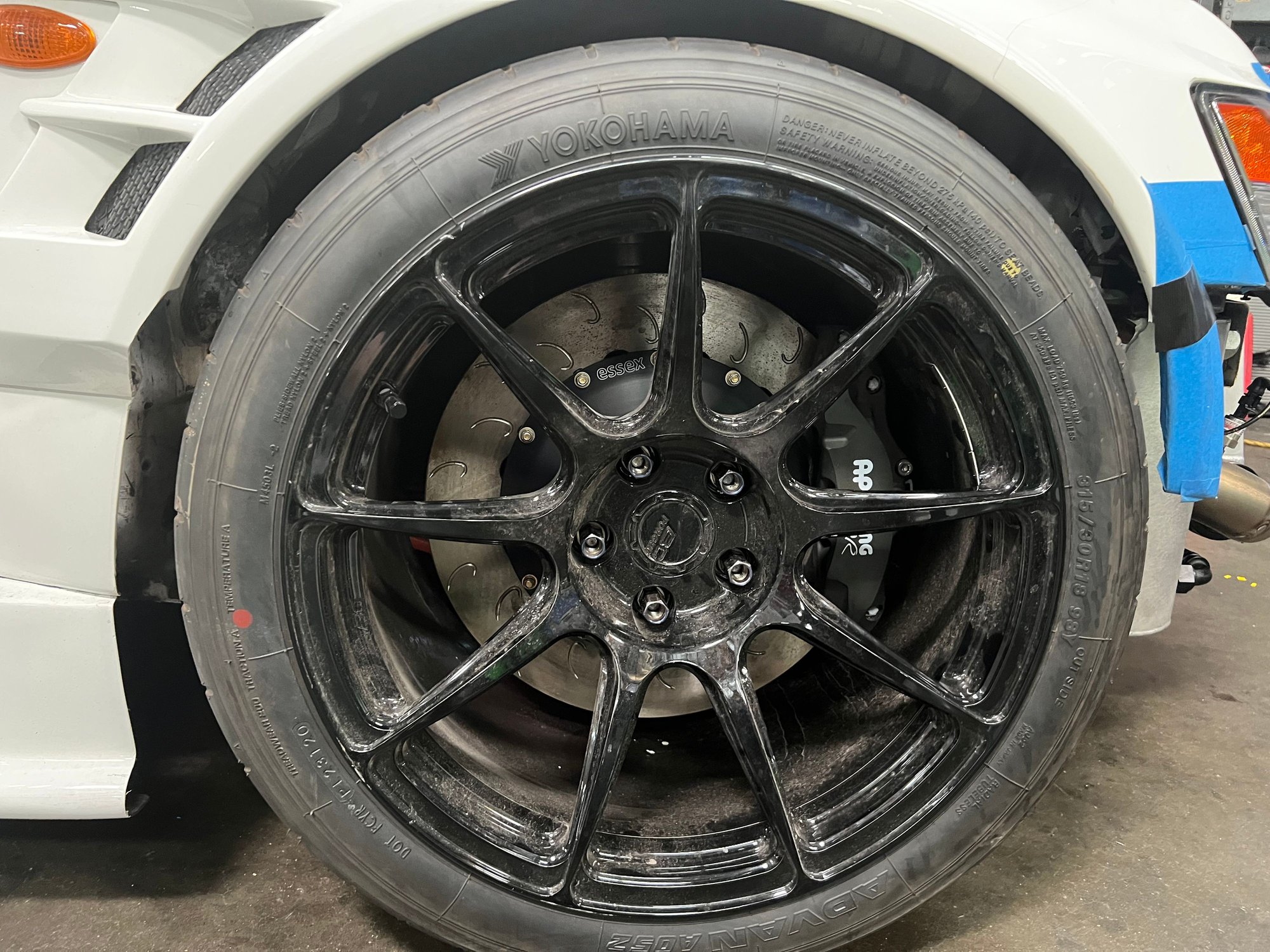

Swaped out my stoptech trophies for these. Will be interesting to compare the two.

those looks kinda small, what are they?
