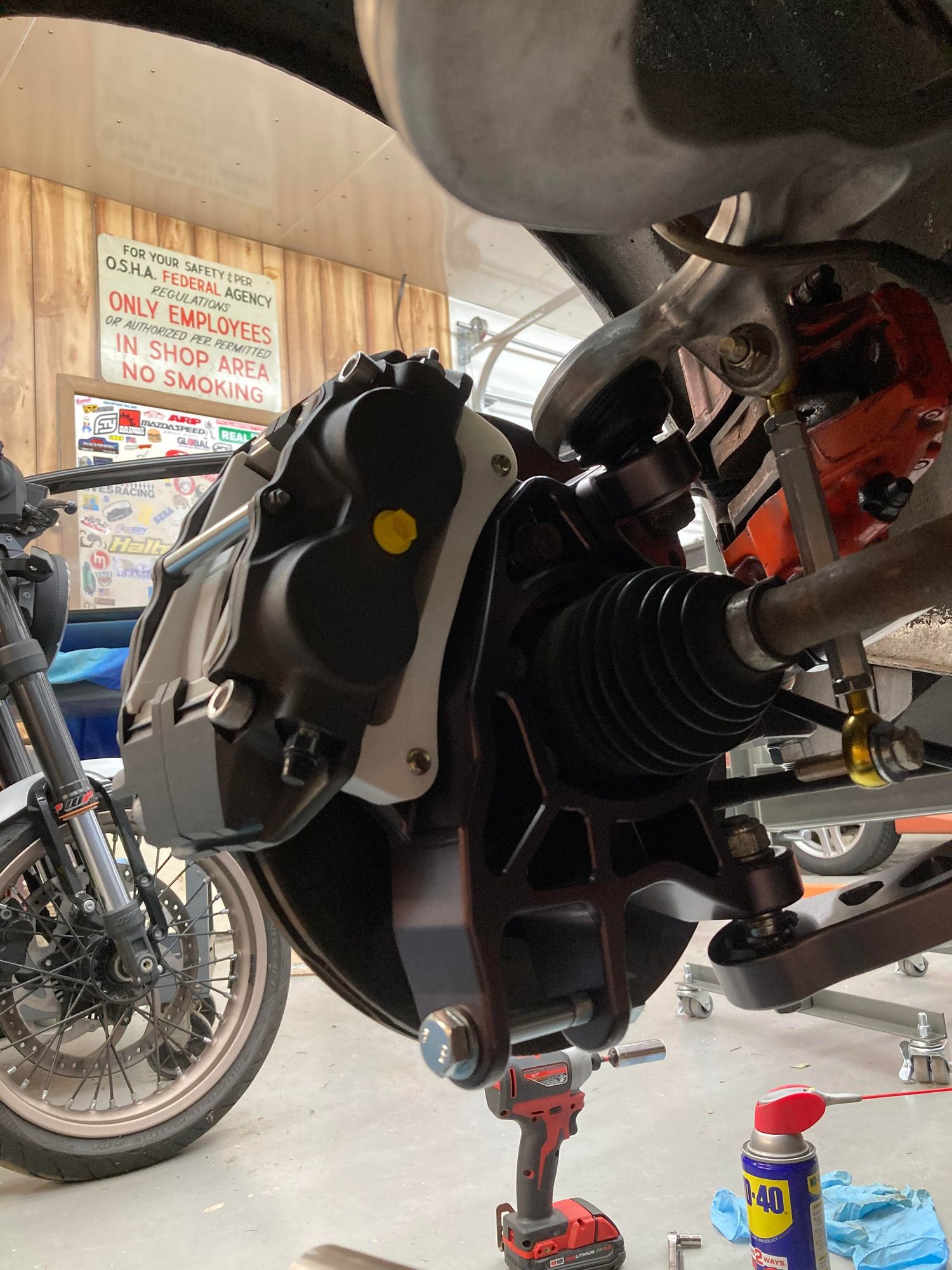

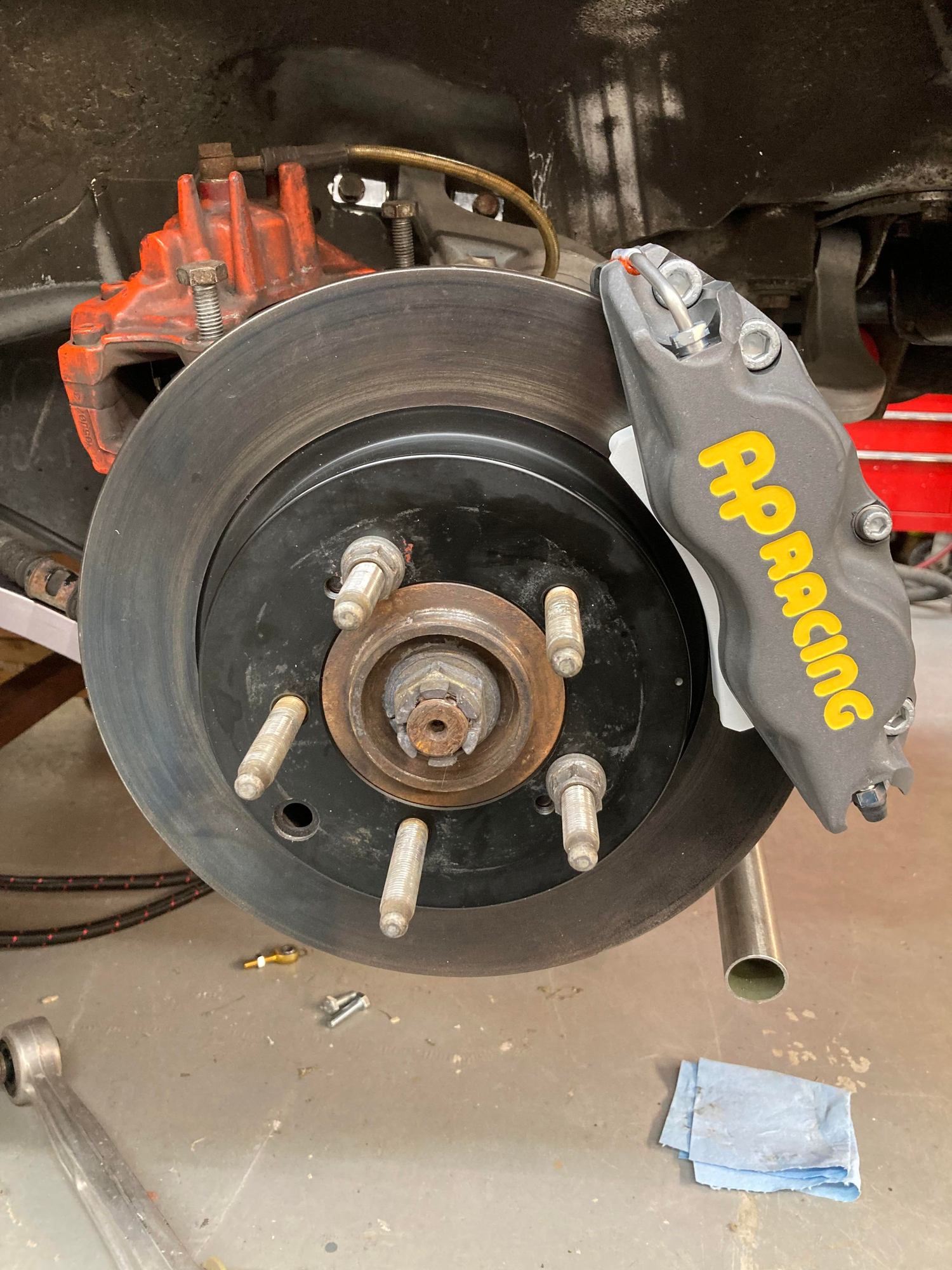

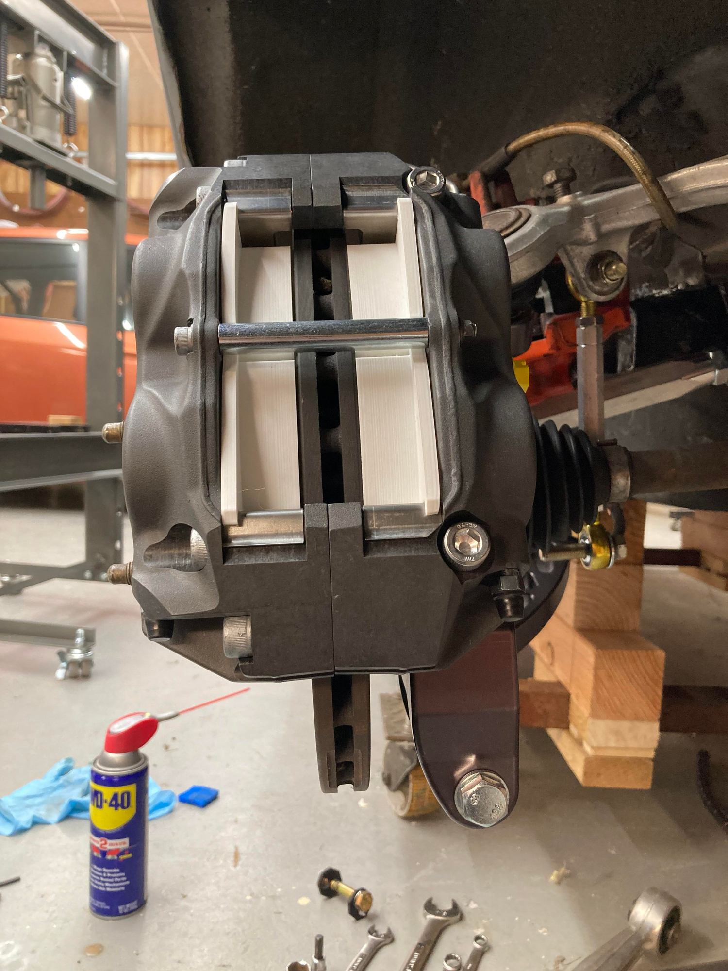

Working out the final tweaks for the rear AP brake setup. Ignore how thick the pads are, they're printed extra thick to keep things in place while measuring.
- Uses a small piston CP8350 caliper so bias is within 2% of stock
- Uses factory rotor so parking brake can be retained and keeps consumable cost down but also allowing for use of 2 piece rotors if desired
- Pads are way larger so they'll last way longer without being much more expensive
- Caliper is stiffer than stock for more even pad wear and better pedal feel. Also brings all the typical AP caliper advantages to the table, stainless pistons, knockback springs, no melting boots etc.
- Compatible with stock and SSB knuckles/uprights
Shoot me a message if you're interested. I'm getting quotes from my machine shop soon. I don't see a huge market for this so will likely be a one run and done deal.

You going to make a set that mounts the calipers right side up? Just playing, good investigative work and solution!

Haha thanks. Yea the other side of the car is just busy with other work and this one had more space. Only ordered one caliper to make sure a bracket was even possible.
