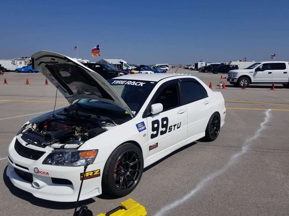

I'm only dealing with wheel hop on launch now. I haven't experienced any of the bouncing/hopping/pogo stick feeling on sweeper type turn exits, ever since I went down in rear rate and also lowered the hell out of the rear of the car. It's super low partly because of a 200lb drop in rate. Unsure if the change from an 8" to 7" spring has any impact on that.
I'm wondering if I'm now TOO low and because I'm sitting so low I don't have much compression travel? My thought process was to keep it low to try and tame the rear down.
Here's a pic for reference!
Evo IX RS
