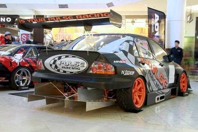

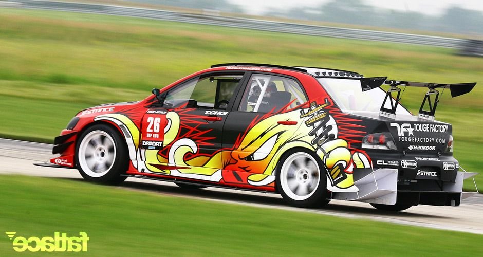

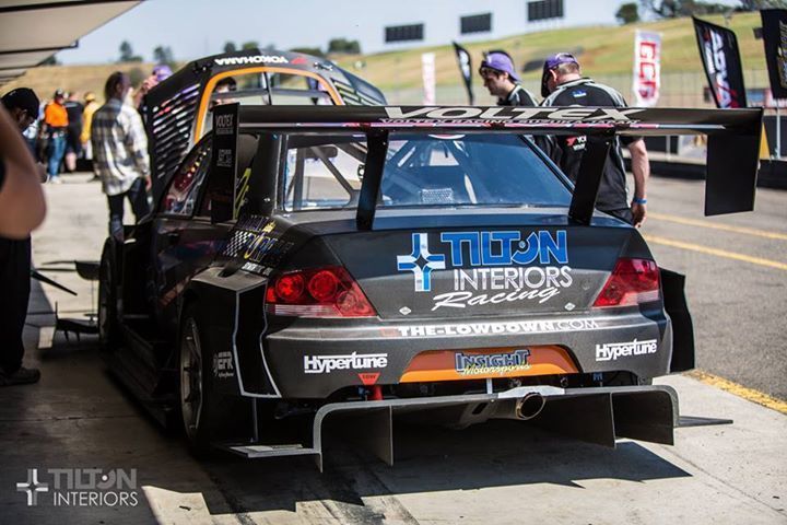

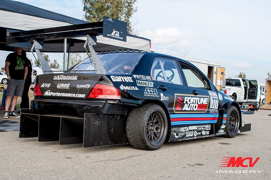

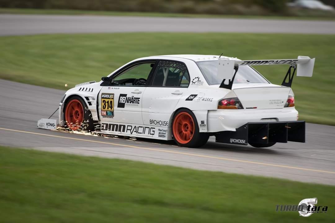

I suppose I'm in an argumentative mood. I also guess none of these guys know what they're doing...

And there are plenty more examples of reducing aero drag caused by the rear bumper on evos in drag racing.

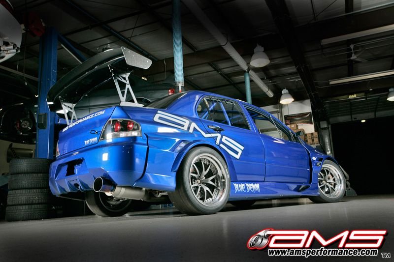

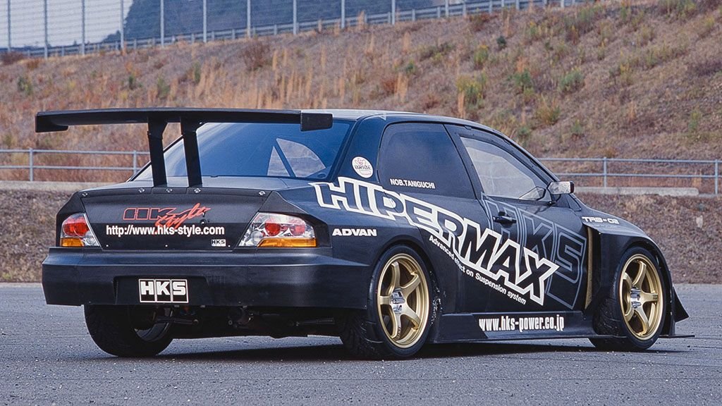

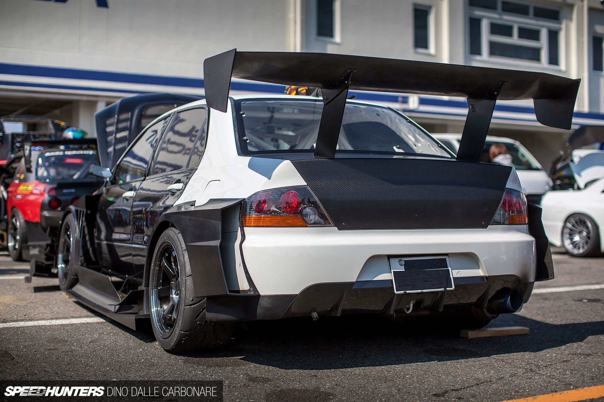

and there are plenty of this...whats your point?

Not one of those is a current day record holder or even competes, and aero development has come a long way.

Not to mention your looking at the rear bumper but cant see the rear quarters under those over fenders. Talk about cutting...

Never said I was against modifying the body if it was necessary to fit wider wheels or for a purpose, cutting up the rear bumper just isn't necessary. Cars I posted still look like evos, there are no exposed open cuts.

First of all, yes you did insinuate that cutting up an evo offended you lol. Second, all of the evos you posted have after market or modified body panels with cut outs to decrease drag and lift. 3rd of all, the advantage of doing so is not solely about drag. There is some weight reduction in removing the spare tire well, and in collaboration with an effective diffuser you can increase downforce. And as Austin pointed out you can access the rear suspension without jacking up the car.
